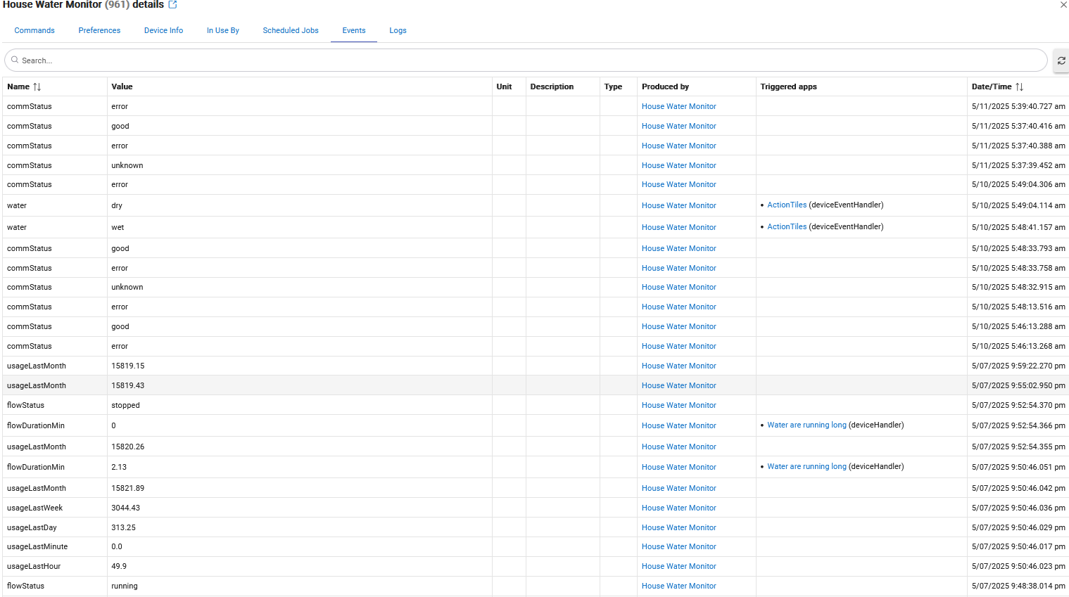

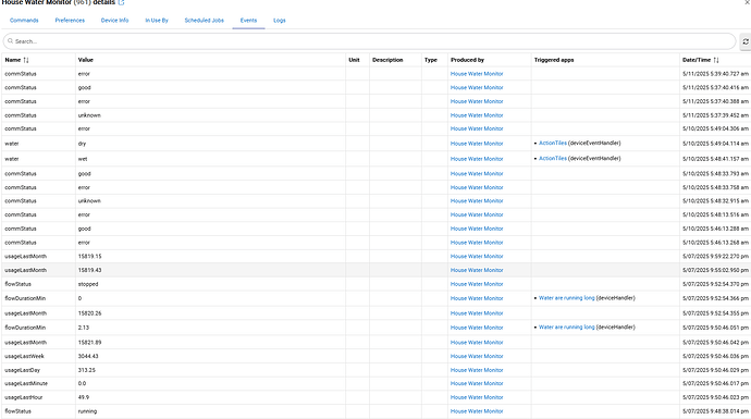

few days ago it stopped reporting but I can see data coming in the debug logs but not in the Hubitat device nor in my Grafana (Influx DB).
This is what I see in the logs but having hard time to understand where is the issue.
I did try to remove and recreate the device again but it ends with the same exact results.
Commstatus end in error for some reason. nothing changed lately on my end.
dev:9612025-05-10 05:55:05.418 AMerror
error: status code: 400, reason phrase: Bad Request @ Line: 986
dev:9612025-05-10 05:55:05.415 AMdebug
httpPostExec() failed: status code: 400, reason phrase: Bad Request
