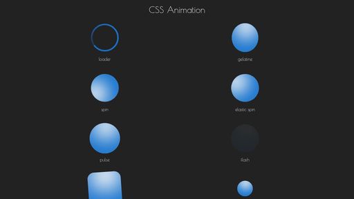

Though you may want to use animations instead, like pulse:
#tile-335 .tile-primary.on {transform-origin: center; animation-name: pulse; animation: pulse 1s infinite ease-in-out alternate; animation-duration: 1000ms; animation-iteration-count: infinite; animation-timing-function: linear;} @keyframes pulse {from { transform: scale(0.8); }to {transform: scale(1.0); }}
Or use any of these other animations (the css for all of the examples is in the editor on the page), and they can be adapted for the dashboard like the ones above.
