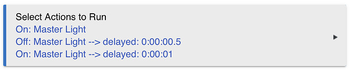

Well I just learned something new, RM can do millisecond delays, all you have to do is put a decimal in the seconds field. IDK why I didn’t think of that earlier. For anyone else this is what worked to trigger LIFX light restore. @bertabcd1234 thx for the back and forth it helped w/ the inspiration.
Now I would have never suspected that the second delay is cumulative. that's very interesting. I would have expected a second 500 milliseconds delay:wait is the second delay calculated from the initial on, or from the off?
I think I've been doing this wrong for about a year?
The second delay is calculated from the time when the second On is processed.
The first On action is run, then the Off is run which is scheduling the light to go off 0.5 seconds from its running, then the second On is run which is scheduling the light to go On 1 second from its running. I suspect the On-Off-On actions are run milliseconds from each other.
I would recommend making a test rule similar to this so you can see how fast the commands are executed. I believe it'll help your understanding of a delay on an action.
Edit: I just made a test rule and my logs show 100 ms to run through the On then schedule the Off then schedule the On actions.

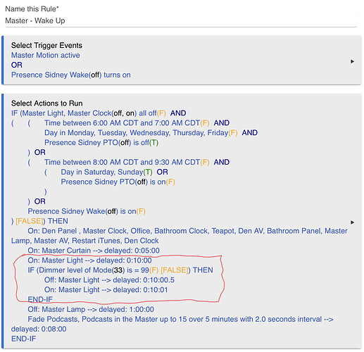

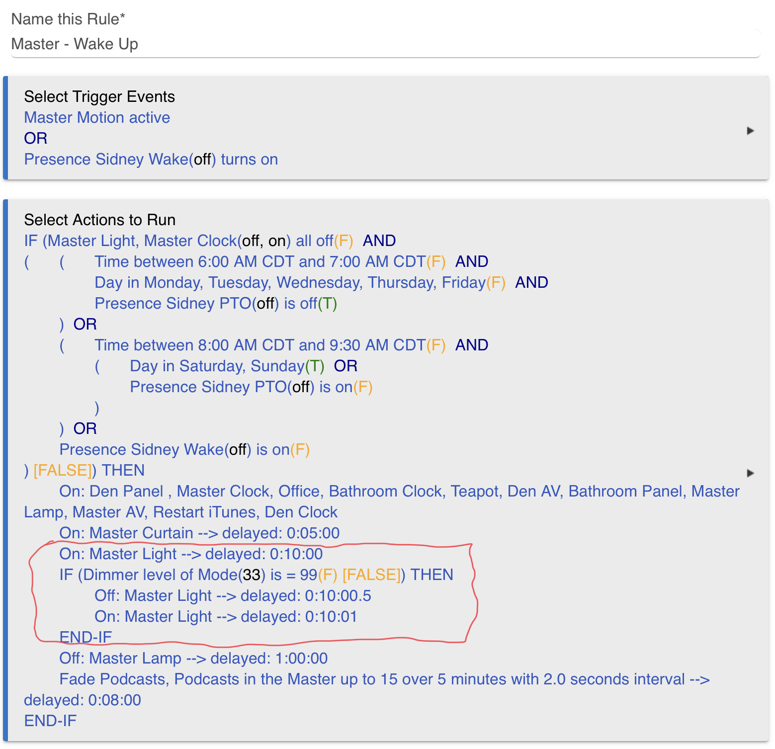

The delay is calculated from the trigger evaluating to true, my previous example was a POC test, in practice this is how i use it:
In the section circled in red the master light will turn on 10 min after the above conditions are true. if it’s Late night mode (If dimmer level of mode is 99) then it will also turn the master light of and back on again 500ms apart. This is my wake up automation for a very gentle wake up. :nerd_face:
I know I'm splitting hairs here and it probably doesn't make a difference but let's be accurate. The delay is scheduled when that particular action is run. The On and Off have no idea when the condition evaluated as true.
