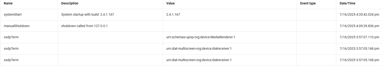

First Ever Red Light and Hub Stopped working C-5 running 2.4.1.167
Came home and my door didn't auto unlock. Lights didn't come on. Checked Hub and found Red Light. (on a battery backup) Pulled power for a bit went back to working. Pending disaster??
Usually means the platform shutdown and the hub is ready to be unplugged or power cycled.
Any chance you have any automations that are configured to reboot or shutdown the hub?
I feel like an idiot, sorta. I found that my Ring Power Monitor had been unplugged somehow. The suspect is a grandchild. It did exactly what is was supposed to do. Thanks for your help
