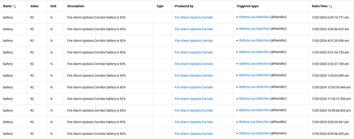

Hi - Installed six First Alert Zcombo smoke/CO sensors couple of months ago. One of them started chirping this morning. Checking the status of the battery shows that it is at 92%. I was expecting a notification when battery is below 50% but since it at 92% there are no notifications but it started chirping. There are two others sensors that are at 92% with no chirp. Does anybody else has such a experience with First Alert? Checked the battery voltage. They are at 1.44V and 1.1V. 1.1V looks low.

One chirp every 40s. Replaced the battery and it is behaving now. I still see the new battery at 92%. Will check it again at night.

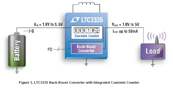

You have a point. We can do that easily in modern cell phones using something called coulomb counting. Here is a good article on it and a regulator that does it. At $4, it may be cost prohibitive for $10 to $20 z-wave devices.
