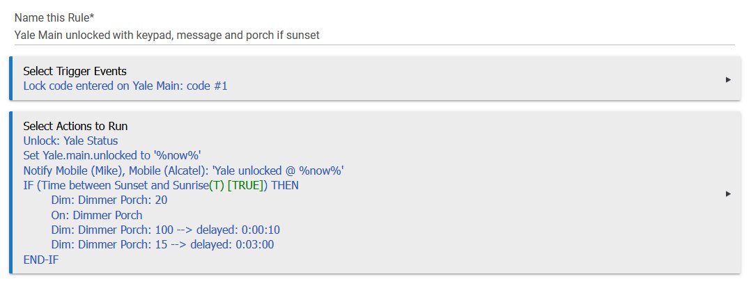

My Caseta related rules are not working (motion => no light activation on various lights) and/or "advanced rules" like this one are working partially (no dim light while running, full light only) .
