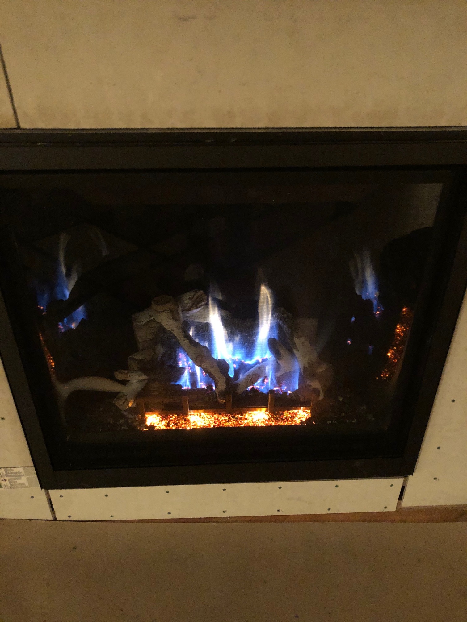

Here is the fire place burning. The ember bed light is stock with this unit. My additional light is not on here.

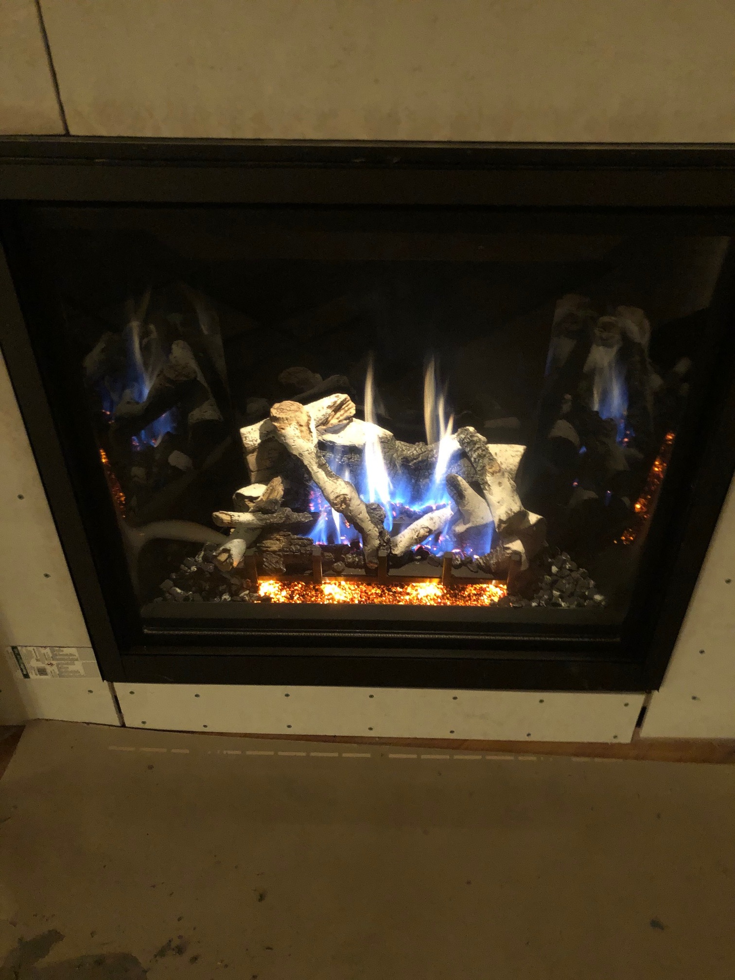

Here it is with my additional light turned on. Of course the light can also be on with no flame for a nice look too.

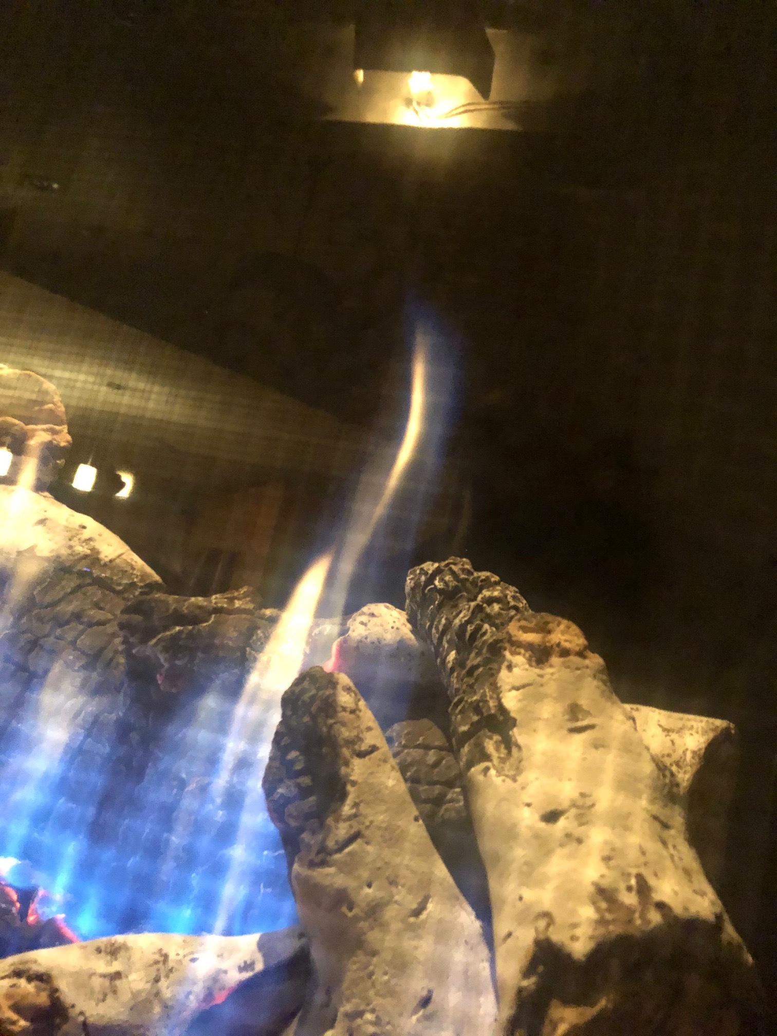

If you look close here... what you are seeing is a reflection off the back of the fire box showing the light I added and a little shade or shield I also added along with the wires. The light is mounted pretty close to the FRONT of the fire box... near the glass but you can see it reflected on the back of the firebox if you look from way down low...
