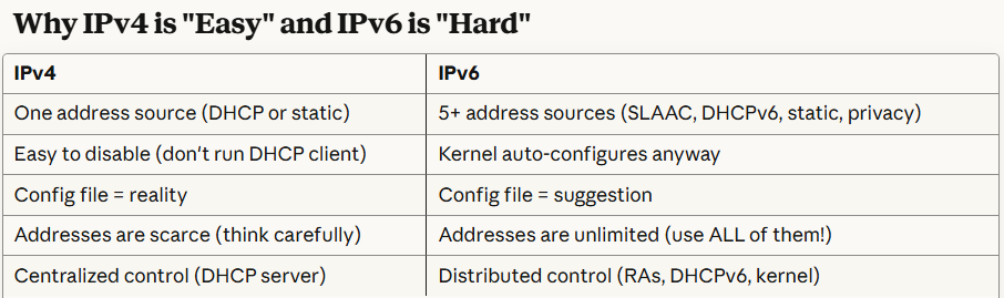

Why IPv4 is "Easy" and IPv6 is "Hard". I just got my Unifi UDM pro to handle IPv6 failover from T-Mobile to AT&T and Starlink. Had to go full ULA on all VLANs, Create NAT Masquerade IPv6 for each ISP and then finally configure the ULA addresses on each VLAN.
