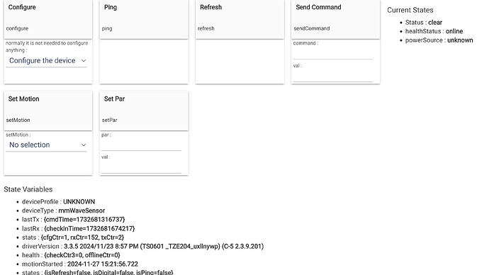

Hi,
I just ordered Tuya 24G mmWave sensor from aliexpress; and tried to use driver 3.3.5.
Unfortunately, deviceProfile shows "UNKNOWN":
State Variables
deviceProfile : UNKNOWN
deviceType : mmWaveSensor
lastTx : {cmdTime=1732681316737}
lastRx : {checkInTime=1732682337550}
stats : {cfgCtr=1, rxCtr=355, txCtr=2}
driverVersion : 3.3.5 2024/11/23 8:57 PM (TS0601 _TZE204_uxllnywp) (C-5 2.3.9.201)
health : {checkCtr3=0, offlineCtr=0}
motionStarted : 2024-11-27 15:21:56.722
states : {isRefresh=false, isDigital=false, isPing=false}
endpointId: 01
application: 4A
inClusters: 0004,0005,EF00,0000
manufacturer: _TZE204_uxllnywp
model: TS0601
outClusters: 0019,000A
softwareBuild:
tuyaVersion: 1.0.10
The following is the debug log (right after I switched it off for 10 seconds), that hopefully help you

Hi Jo,
You have submitted everything that I need to add this new device to the driver; thank you! I hope to get it done this weekend.
Thank you! Please let me know if there is anything I can assist with
@Televisi @panu.saarela , please update the driver manually to version 3.3.5 "2024/11/30 5:53 PM"
  • added TS0601 _TZ6210_duv6fhwt (Heiman presence sensor)
  • added TS0601 _TZE204_uxllnywp
@Televisi after updating the driver, select 'LOAD ALL DEFAULTS' from the Configure command drop-down list and click on the button above.
Thank you!
I installed it and it is able to detect the device now!

This is a variation of 'TS0601_YA4FT0W4_RADAR' .. I will add it in the next driver update, for now you can set the correct device profile manually :
Hmm, I made an educated guess along those lines and tried that profile previously but it doesn't seem to "stick". Nothing changes when I save and refresh - device profile is still UNKNOWN, and I don't get any of the usual presence sensor configuration parameters that I have for the other version of this device I have. (e.g. sensitivity, distance, etc.). I tried selecting it and refreshing multiple times and also tried "loading all defaults". Is there something else I'm missing to force the profile so I can get the configuration parameters?
I see issues with the new beta platform UI... It is better to wait until these are clarified and fixed in the next updates.
I upgraded the Hubitat Beta to the latest version and that allows me to set the device profile now so making forward progress. I was also able to set the fading time and have it "stick". However, when I try to change the min / max detection distance and save, they don't update on the Current State and when I refresh and go back to preferences, they've reverted to the defaults.
I did run into a UI bug as well where it won't let you put a decimal point in any of those fields - I can use the one that's there and edit around it but can't clear the field and type one in naturally.
