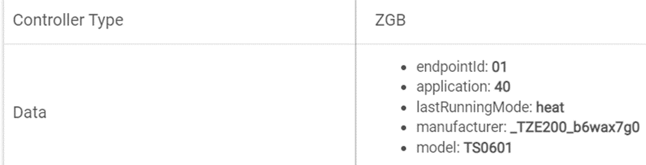

Controller type and states

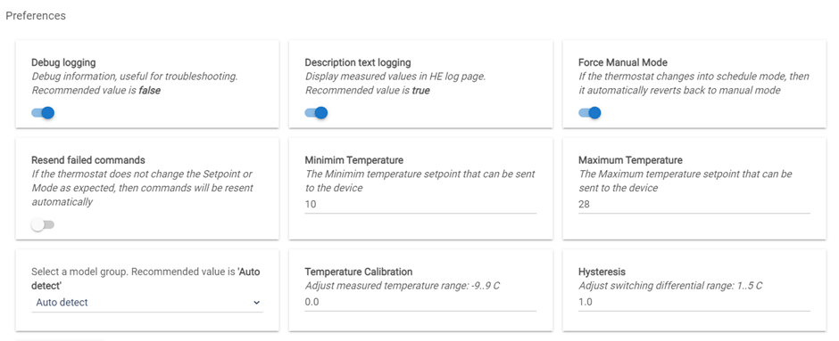

Preferences

I have reviewed the current code for BRT-100 ( _TZE200_b6wax7g0 ) and applied some fixes.
Please update to the dev. branch "1.2.6" timeStamp "2022/10/18 8:33 PM". As I am not sure whether it is working before, please retest again the following settings:
  • A1 (temperature compensation) - preference named "Temperature Calibration", 1 deg. step +/-
  • A5 (min. temp) - preference named Minimum Temperature , 1 deg. step
  • A6 (max. temp) - preference named Maximum Temperature, 1 deg. step
After you change these parameters values from the driver web page and press Save, check from the TRV touch panel whether the new values are accepted.

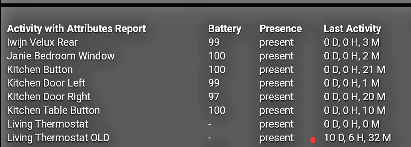

Hi,
The "Presence" attribute is available, should it already work (presence --> not precence or is it a work in progress?
Hi Bruno!
Yes, the presence should be already working. If there is nothing received from the thermostat for 4 or more hours, the "presence" attribute should change to "not present".
I hope that during the incoming weekend I will finish whatever remained in this driver.
EDIT: just noticed for one of my 2 thermostats the 'pollPresence' periodic scheduled job was not running by some reason - so one more item in the check list!
I confirm, there is 1 thermostat offline but still present
