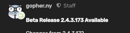

If you are running .173 that's beta so you should to move this to that forum for resolution/help?
Cheers
Not running .173 anymore, how do you tell if it's beta? It just appears as a platform update in top right corner. Surely if it's a beta release it shouldn't be flagging up as general update?
.173 isn't beta - it's now the current prod release.
I checked before replying in the beta forum.
Strange.
It was initially a beta -- it was released to prod pretty quickly.
Well this seems to be a confusion of release awareness but that aside this isn't my issue and with all due respect this isn't the thread to be discussing if it's beta.
