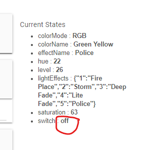

Thanks for responding. The specific issue is the "current state" does not update. Mine is stuck at "off" I recall others being stuck at "on" so perhaps it is the luck of the draw on installation.
John
I have 3 and one is stuck on ON one stuck on OFF and the other is sporadic :crazy_face: .
Right so its the parent device, you tell it to turn on, and the device turns on, but the driver state doesnt change to on?, is this it?, same for off presumably?
Exactly....

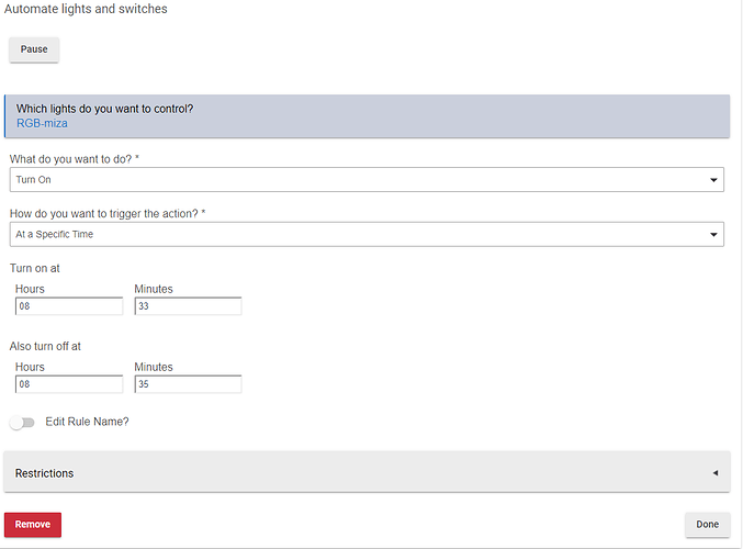

So you can turn on/off your RGb lights on specific time? Because i cant. Was trying to put all the light into scene and put it into Rule machine, it doesnt work.

So i am not gonna lie, i am struggling on this one. In logs i see that lights turn on and off when i set it in "Simple lighting", but they dont turn on. Is it possible for you to try if it works for you?
I am using RM4.

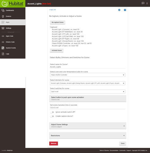

If you give me a snapshot of your Simple Lighting screen I'll see if I can get to where you are.
Under Which lights do you want to ccontrol i have my Scene activator.
Its been a while but I think the key is the Scene name and the Scene Actuator name must be the same.
My Scene:
My Simple Lighting Rule: (works fine)

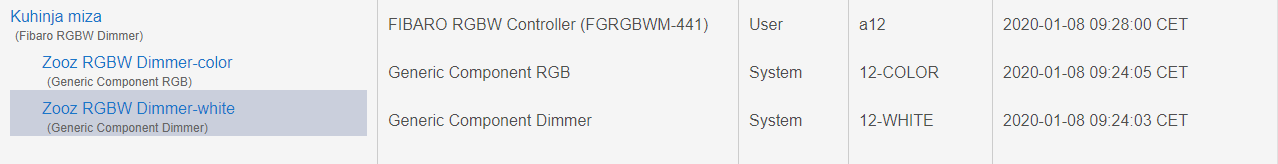

I think i will need help from the guy created a driver for Fibaro RGBW 441. This is a picture where i add my RGBW 442 and it recognise it as ZOOZ. Even thoe i later change it to 441 driver it still has the two permanent ZOOZ devices under which cant be changed. I cant even change color now, whatever i press it stays White. On/Off working properly. In my Dashboard i created color bulb for my RGBW 442 which showing the correct color i choose but thats all. Am i doing something wrong or this device just isnt added to Hubitat yet?
