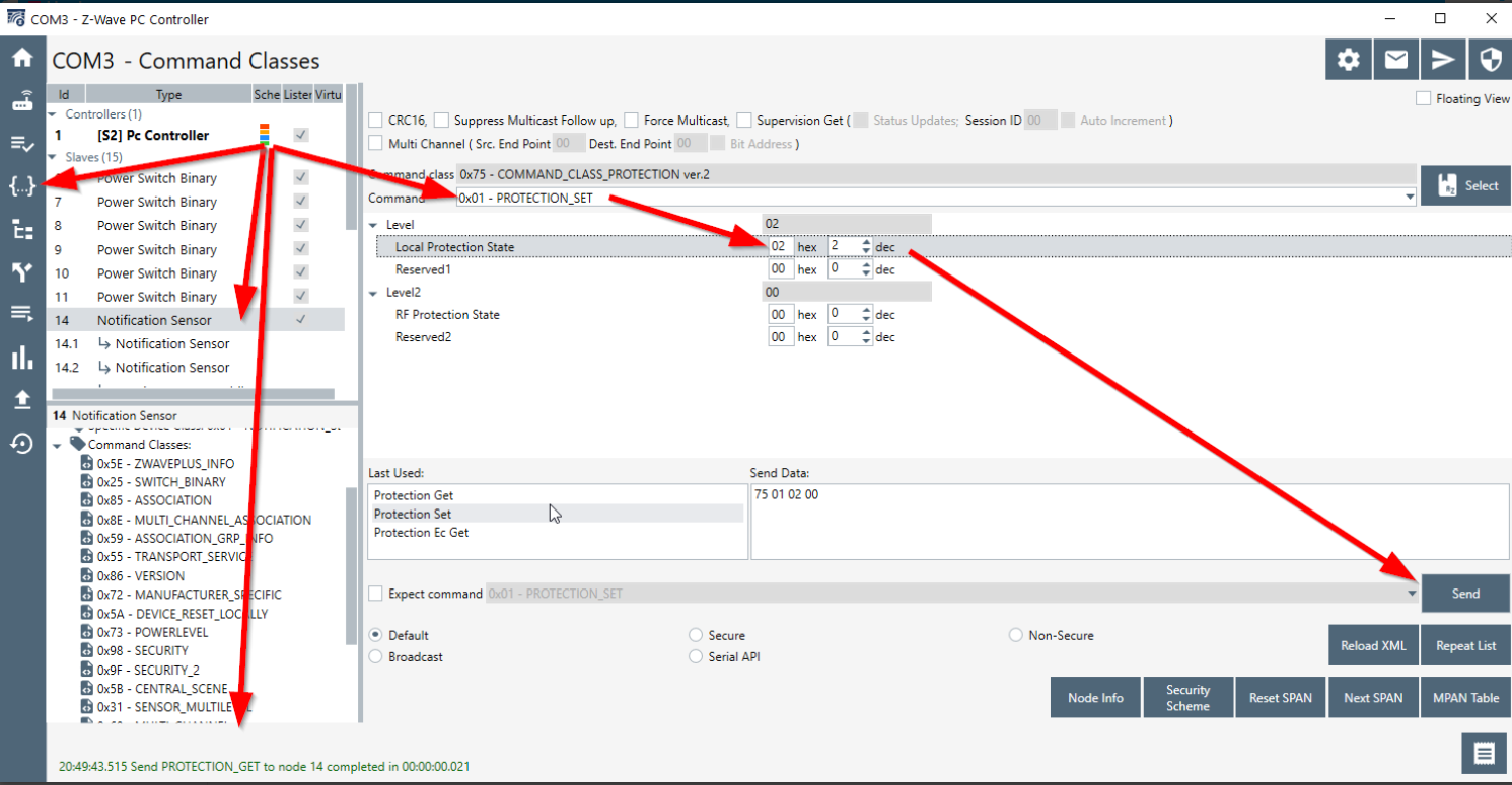

Ive just been doing some modifications to my driveway gate and have come across this issue as well. After some research it seems to be a configuration issue outside the normal parameter adjustments. According to the folks at fibaro this can be resolved by sending the following raw command to the device (be carefull as if done incorrectly you can brick your device)
"Node-ID, 0x60, 0x0D, 0x00, 0x06, 0x75, 0x01, 0x02, 0x00"

I am going to try and get my aeotec stick working to see if I can manage this from there.
I will let you know how I get on
So I couldnt find a way to send the command via the hubitat hub but using a zwave stick and PC controller I was able to resolve this issue
Obviously make sure you send the command to the correct node!!!!
