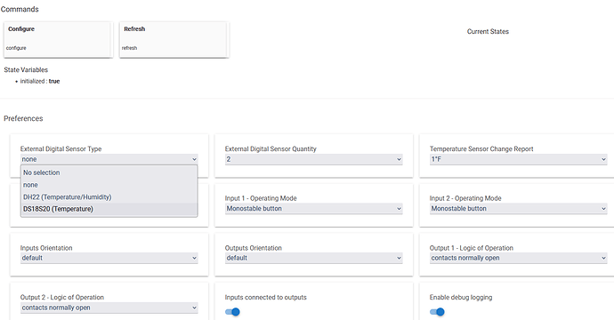

Got a Fibaro FGBS-222. Wanted to hook up three temperature sensors to it. Even though Fibaro manual say the temperature sensor is DS18B20 but when I paired the device it shows DS18S20 as a device in drop down menu as shown. So I bought DS18S20. Looks like it does support DS18S20. Now the issue is it cannot read more than one external sensor. One sensor works fine. Any thoughts before I buy DS18B20 to try? I have not installed any separate drivers. Hubitat detected the Fibaro upon inclusion and show all the I/O devices.
