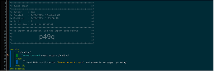

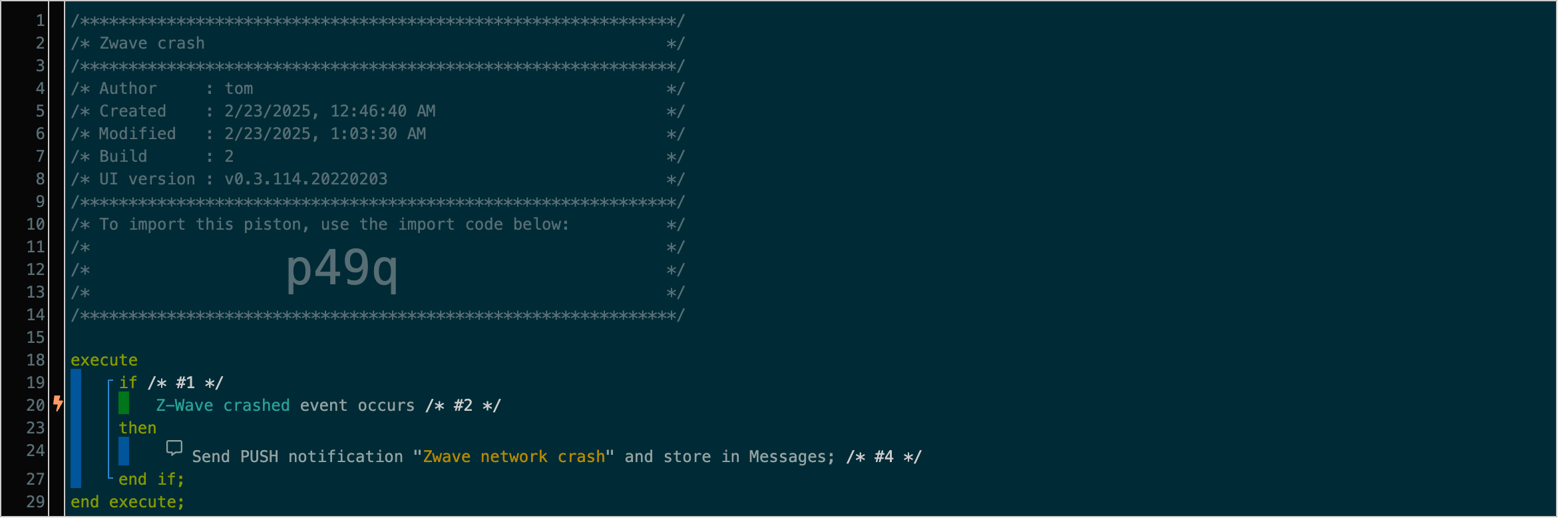

EDIT: I have it fully monitored now with 2 lines of webcore code. That isn't the point. The point is this seems like a critical error that should be immediately reported.

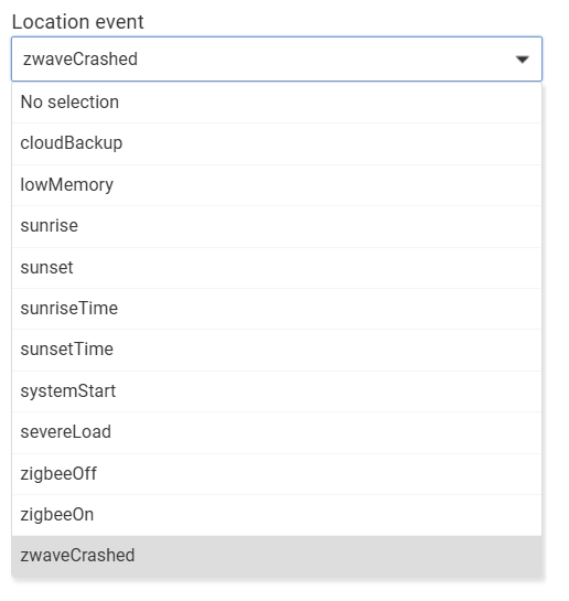

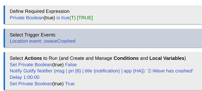

In the interim, you could set up your own notification for the event. This is a rule I set up a while ago when backups were sometimes causing Z-Wave crashes.
I got no UI alert. It was only in "location events" log.

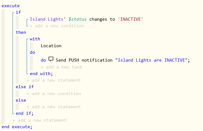

You may want to monitor the device with a rule, to see when the device status goes to INACTIVE state. I can't see how to do it in Rule Machine, but in Webcore you can check $status for changing to INACTIVE
inactive

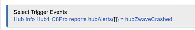

FWIW, you can monitor zwave crashes w/@thebearmay 's Hub Info Device and RM. Alerts available in Hub Info Device driver include zwave crashes:
Should be able to monitor in RM for below using Custom Attribute from Hub Info Device, and then send a notification:
I'm all good, thanks though. I was able to set up an alert with webcore so I can start troubleshooting the network.

I do have the hub info driver installed, but I'm pretty sure the location event I used in the rule I posted above is directly from the hub, not the attribute from hub info.
Yup - that works as well: :slight_smile:
