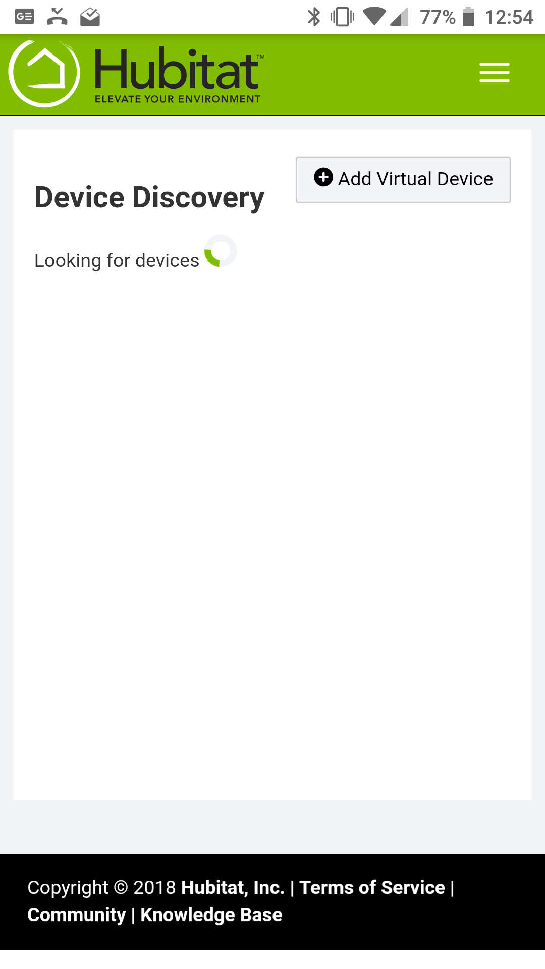

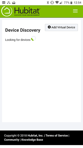

This is already possible by loading the local UI in the browser of your device. You do not need a mobile app for that.
