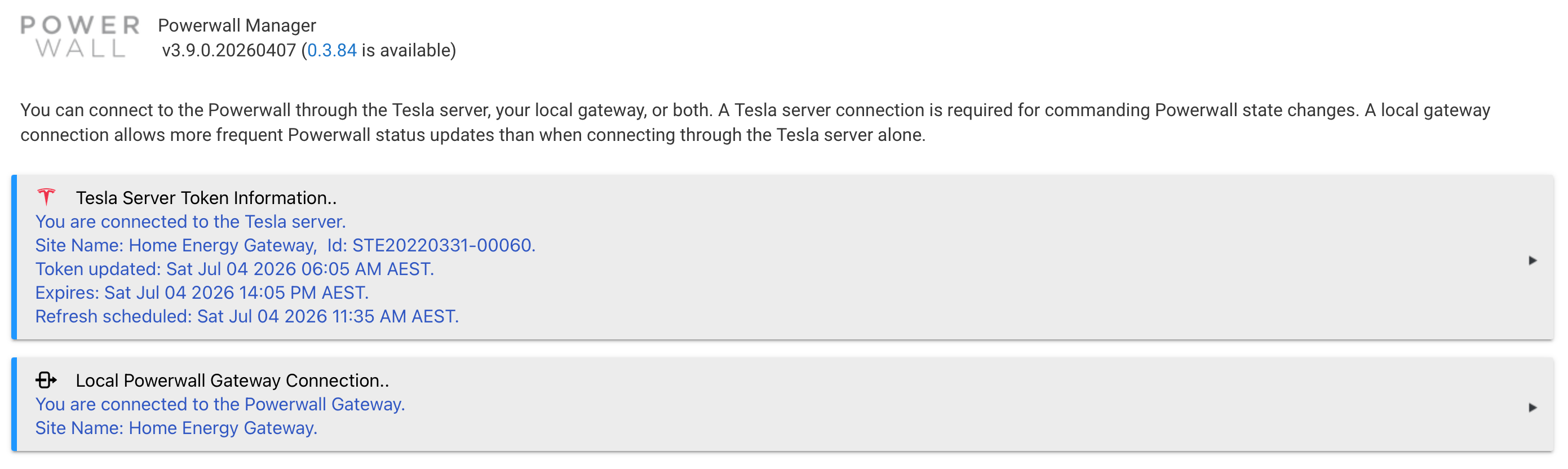

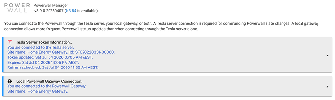

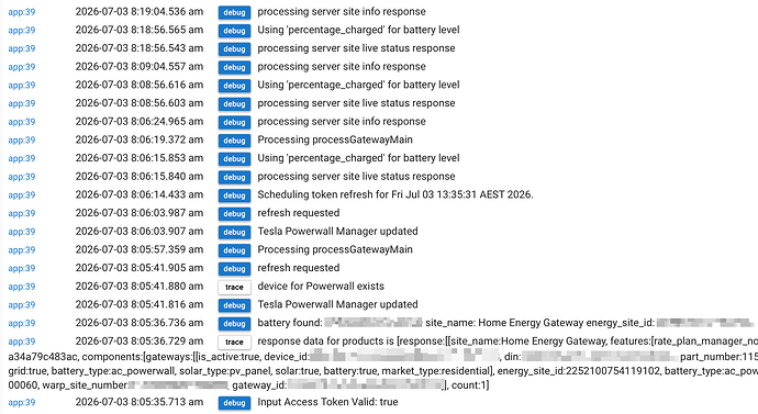

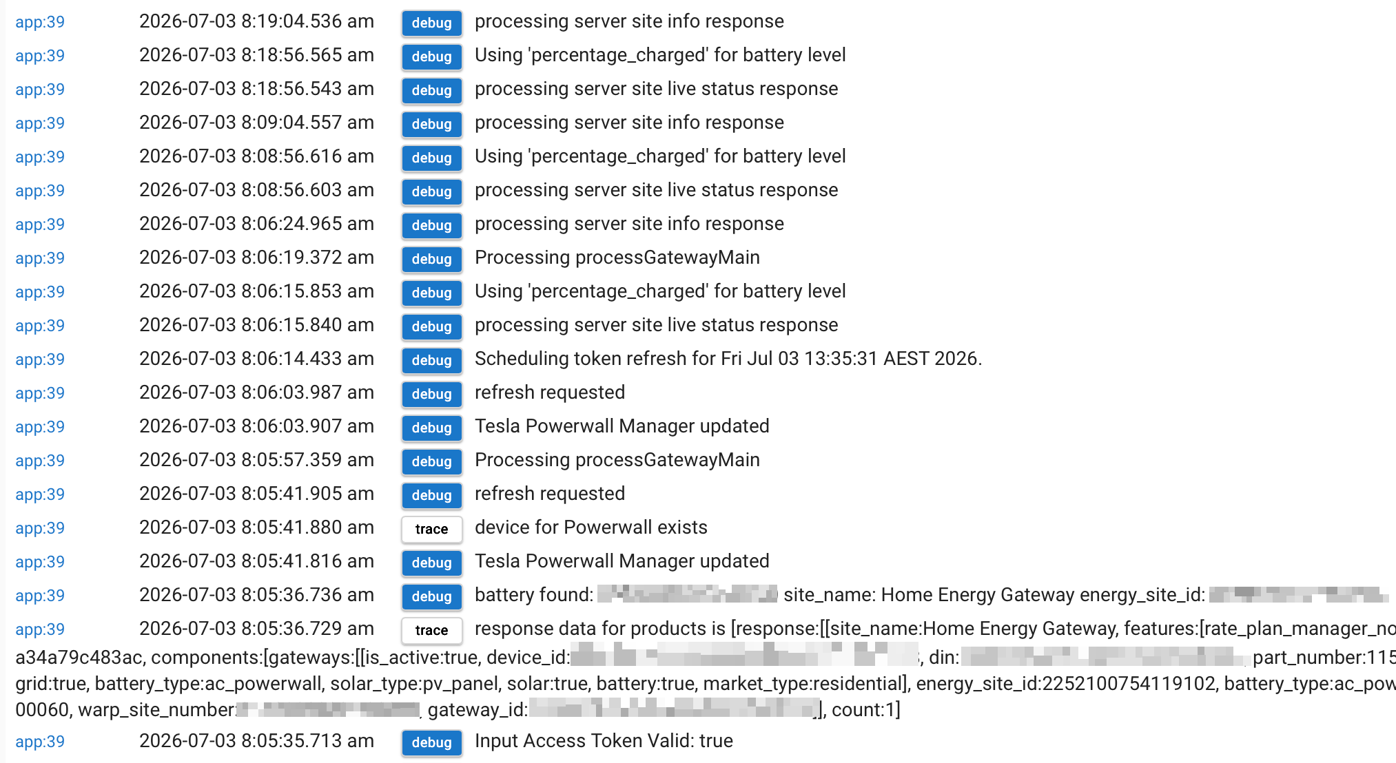

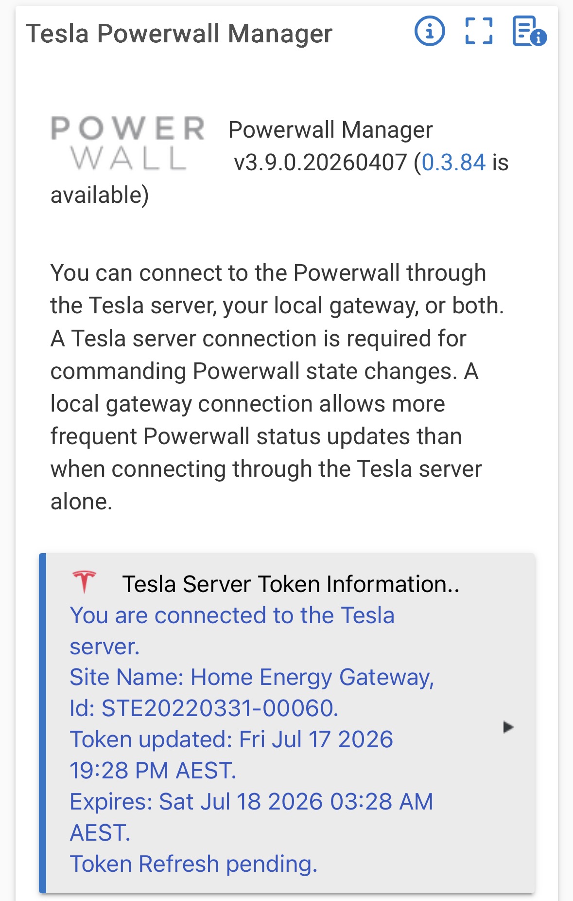

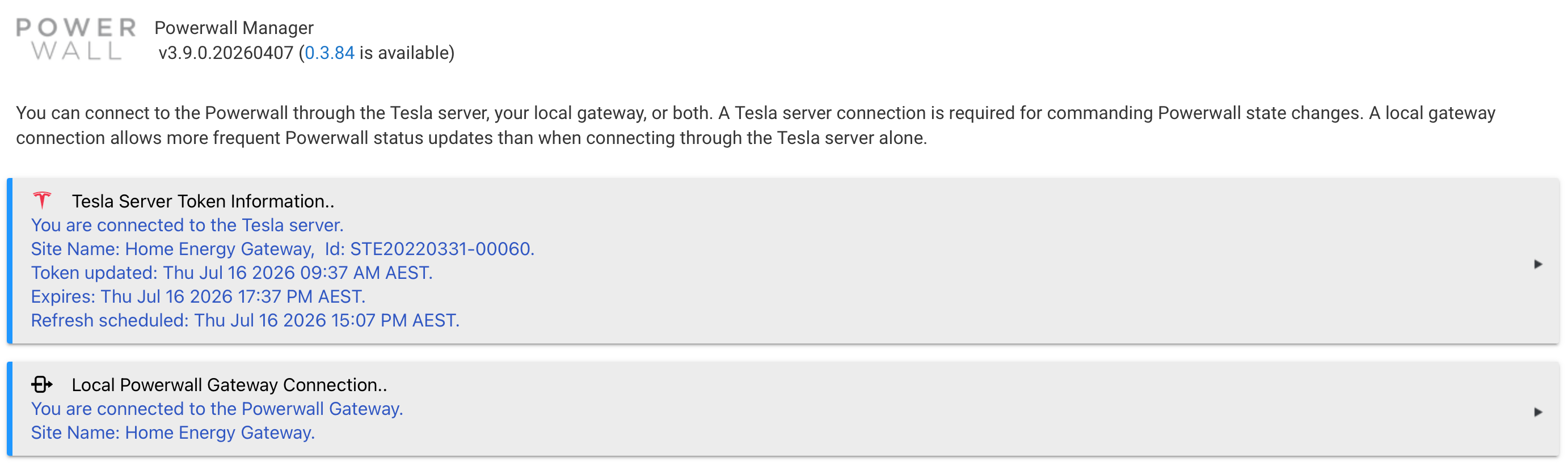

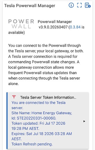

UPDATE: The Tesla app is working again on Beta Release 2.5.1.118! :tada: :smiling_face_with_sunglasses:
from v2.5.1.120 the entire Tesla Powerwall manager app is working 100% (local gateway comms was broken in .118) - Lovely work Hubitat team! :tada::ok_hand:
