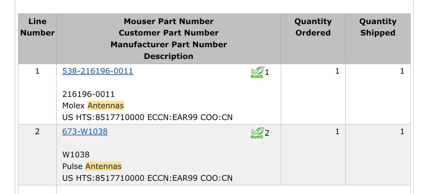

I bought these from Mouser Electronics. The antennas for zigbee and z-wave are not the same frequency. They worked perfectly in a somewhat expansive mixed use environment on a C8. When I set up my C8 Pro I went with the stock antenna expecting to switch them but never needed to.
