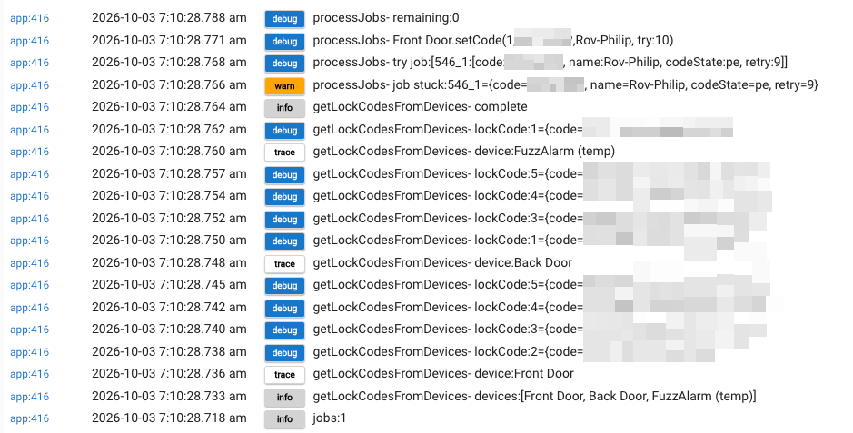

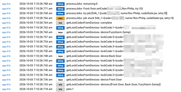

I'm using Lock Code Manager to deal with some codes on a Schlage BE486/BE489 lock. I had it for quite a few years and it's been working great. I haven't added a new code to it for about a year now and I was trying to add one yesterday. Every attempt failed. I was able to delete codes, just not add new one.
I have gone through all the help steps I can think of with the exception of removing and repairing the lock.
There are the logs I've pulled with debug on.

Are you able to add a new lock code directly from the driver details page?

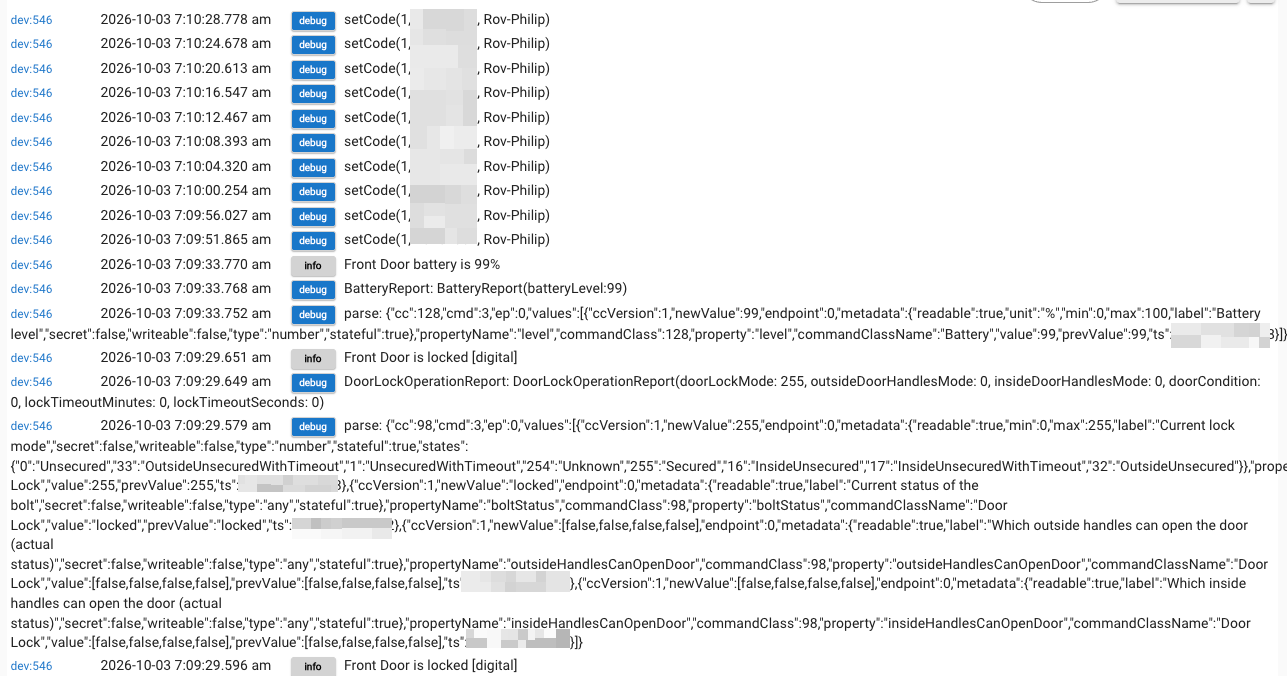

No, it shows up in the state variables but seems to be stuck there. Same when I do it via Lock Code Manager.
I did try to enter a code from the details page that was a new position and name, but the same as another code and it gave me a warning that it was already in use.
The setCode command shows up on the DEBUG log, but otherwise just remains in state variables.
Note that I also changed the batteries to fresh just to make sure it wasn't a battery issue even though it was showing up at 99%.
But otherwise it seems to be stuck.
I thought this lock supported like over 200 codes? I didn't see fetch code return that many. Wondering if this is a routing issue, maybe they ZWave repair on that node?
30 codes, I believe. I can certainly try the repair. Good idea.
It seems to be working for everything else, which is partly why I thought maybe it was related to the Zwave-JS upgrade.

It's working cleanly for me now. But as I noted I had to re-pair the Schlage lock as there was seemingly some issue with the codes getting to it--I assume encryption issues.
So nothing was working here as far as setting codes, I got pissed and decided to rewrite the drivers which ultimately fixed it. I also crafted an app for lock codes with some additional features and functionality. I got some more testing to do this week but I think I am on a good path

One other note about my resolution of this: I did change my Schlage lock from the Schlage driver to Generic Z-Wave Lock. This did not resolve the issue initially, but was in place when I redid the pairing. I still think the ultimate issue was the Zwave-JS and something with the encryption.
