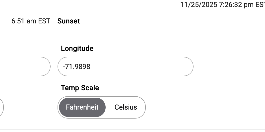

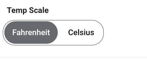

The settings in the Hub Details is set to Fahrenheit. The devices preferences tab still shows temperature reporting as celsius.

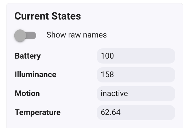

Never mind. I just checked my sensors, and our engineers already compensated for Hue's API shortcoming. Sensor should be set in F, if the hub is properly set up:
The integration converts to F (from the native C reporting) if the hub is set to use these units. Can you please enable debug logging for the affected device, provide those log outputs when a temperature event or refresh/poll on the Bridge device happens, and share that here?

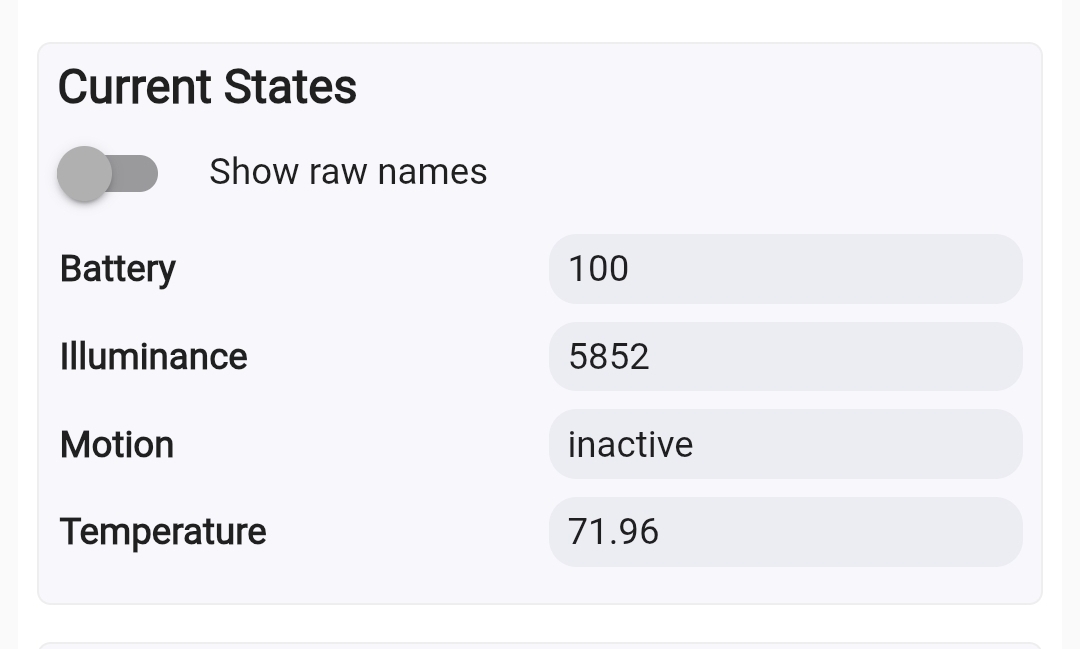

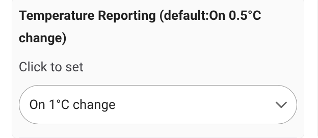

My Hue motion sensors preference adjustments are in C but the displayed value is in F.
I'm assuming the reported temp is controlled by the Hub Details settings.

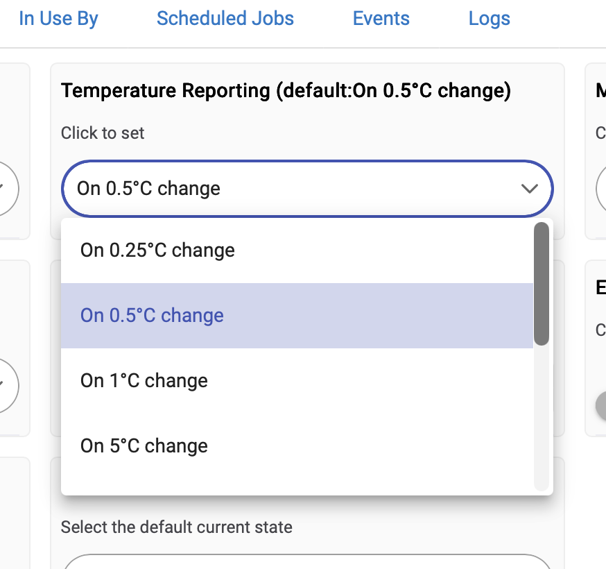

We are talking about the Hue Bridge integration. Your screenshot shows the Zigbee driver.
I see that now. FWIW, the Hue motion sensors work perfectly well paired directly to Hubitat, no bridge required. I have a Hue bridge Pro but only use it for lighting.

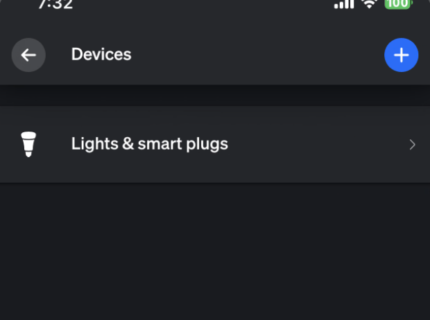

screen shots from the hue app and hubitat.
Devices in Hue app: only lights

That is the Zigbee driver, not the Hue Bridge integration driver. How is your sensor actually added to Hubitat? It can't be added to both via Zigbee directly.
I also don't see evidence of it reporting in Celsius. That preference is always going to display that way because it lines up with how the device is configurable (and the driver doesn't show both units or switch based on hub settings). The real question is what your events actually look like.
its not reporting celsius the hubitat temp reporting change is in .5 celsius increments. it should say fahrenheit.
