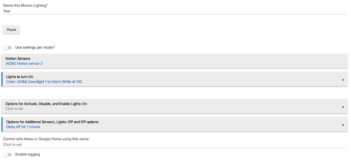

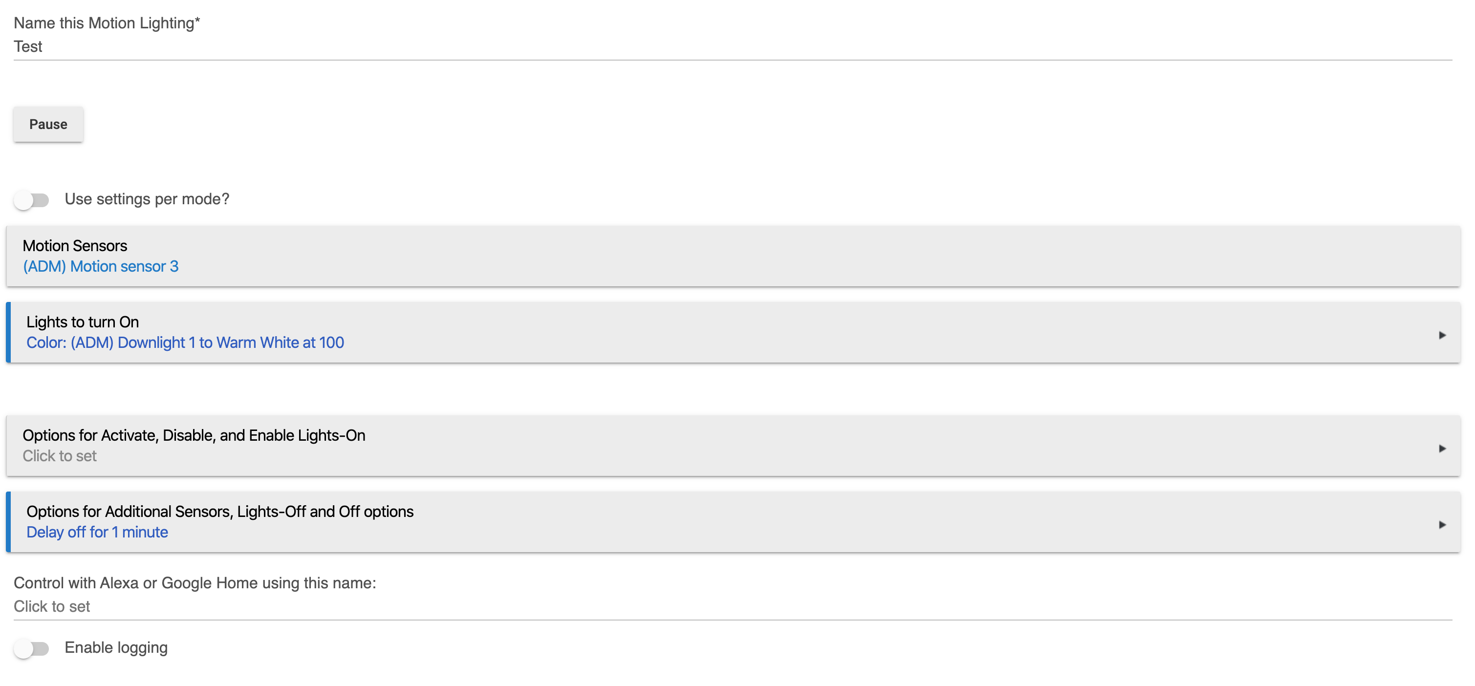

The only other bug (which may be something I'm doing wrong) is that despite being able to easily and reliably change the colour, colour temperature and level/brightness via the device page, apps like motion lighting and scenes seem only to be able to turn the lamp on or off.
That is to say, if the last time the light was on it was red level 100, when the motion lighting app fires it will successfully turn the lamp on, but will only turn it on at red level 100 (not, for example, warm white level 50 as programmed in the app).
This was happening before with the generic zigbee driver as well but I thought I might be able to figure out what was driving that behaviour, alas I'm at a loss :thinking: Any thoughts?
