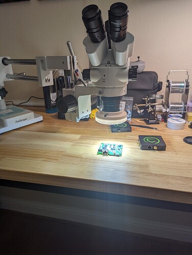

I use a microscope and some precision tweezers for doing these mods. It makes soldering these a lot easier. Some Kapton tape can help too if you have a hard time positions the connector for the first solder.
Do you use the third (photo) ocular or is it a 'maybe someday' thing?
Yes I have a Nikon DSLR and a C-Mount with an HDMI out for a screen when I want it. This scope is Simulfocus and shares the left field of view without blocking it when using the third port.
I purchased a similar scope years ago for my Assembler and she loved it, of course. I always wondered if I should have gotten the third ocular, just in case. Thanks! :smiley:
I use the eyepieces when actually soldering but the screen is good when doing board inspections. The screen is handy when showing people something so they aren't smearing their eyeball gunk all over my eyepieces.
Not gonna lie this picture pleases me
