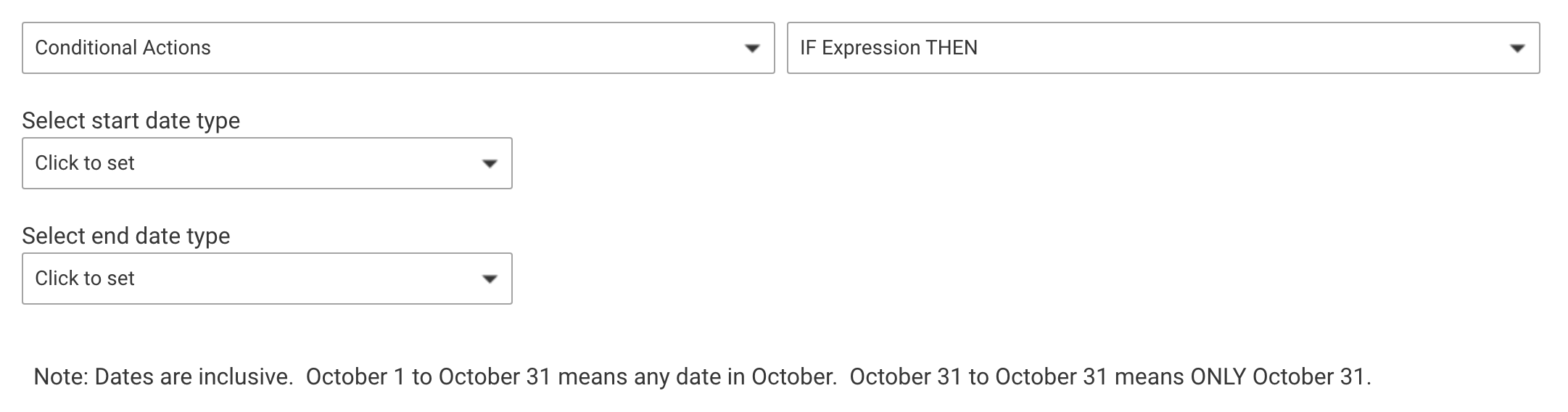

You could create a RM rule that has two conditional actions in it. For the first, add a condition for the Fall and Winter months, and for the second conditional action, add a condition for the Spring and Summer months.
You can have both conditional actions in one rule, with just a single trigger which would still be Sunset with no offset. Sunset + offset would be one of the two conditions for each of your conditional actions. Just make sure each conditional action in the rule has the following structure:
IF (conditions)
Then (actions)
End-IF

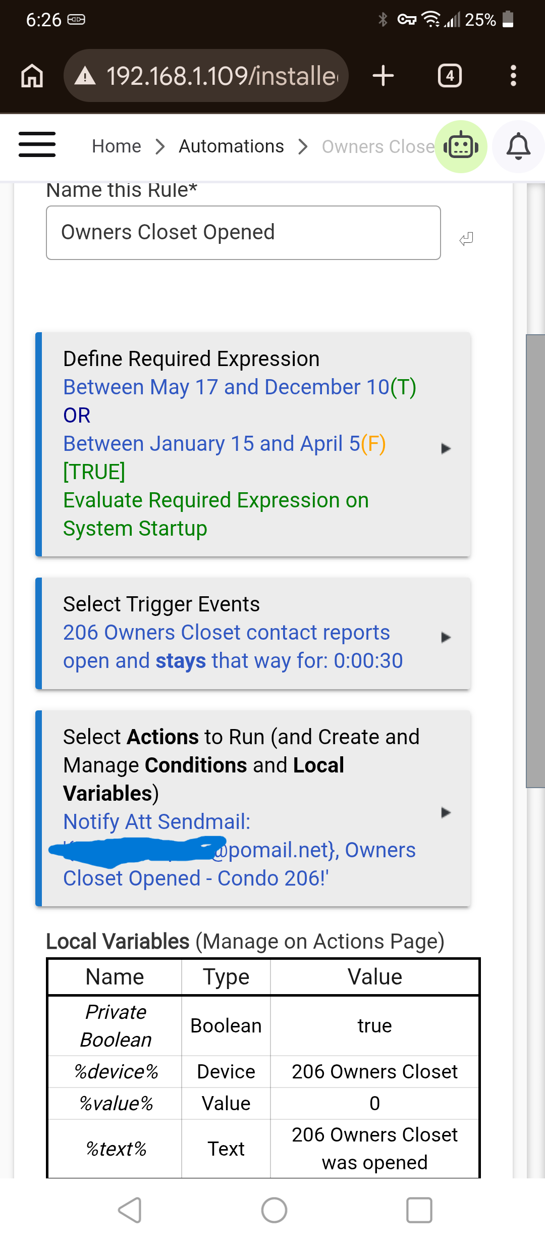

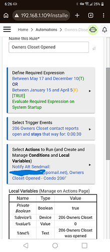

Or, as mentioned separate it into two rules with a date clause like I do here to alert me if someone opens our locked owners closet in our rental condos. But only for dates we are not normally there.
