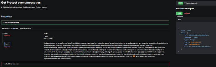

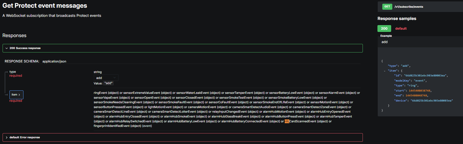

app:11425/29/2026 2:01:46.737 pmdebugParsed JSON: [item:[metadata:[fingerprint:[ulpId:null]], start:1780077705421, end:1780077715421, id:abcd56789abcdef123456789, type:fingerprintIdentified, device:123456789abcdef123456789, modelKey:event], type:add]
app:11425/29/2026 2:01:46.735 pmdebugcomponentParse: {"item":{"id":"abcd56789abcdef123456789","modelKey":"event","type":"fingerprintIdentified","start":1780077705421,"end":1780077715421,"device":"123456789abcdef123456789","metadata":{"fingerprint":{"ulpId":null}}},"type":"add"}
app:11425/29/2026 2:01:46.111 pmdebugparseNvrJson()
NFC Read
app:11425/29/2026 2:04:58.019 pmdebugParsed JSON: [item:[metadata:[nfc:[ulpId:null]], start:1780077896725, end:1780077906725, id:987656789abcdef12345abcd, type:nfcCardScanned, device:123456789abcdef123456789, modelKey:event], type:add]
app:11425/29/2026 2:04:58.017 pmdebugcomponentParse: {"item":{"id":"987656789abcdef12345abcd","modelKey":"event","type":"nfcCardScanned","start":1780077896725,"end":1780077906725,"device":"123456789abcdef123456789","metadata":{"nfc":{"ulpId":null}}},"type":"add"}

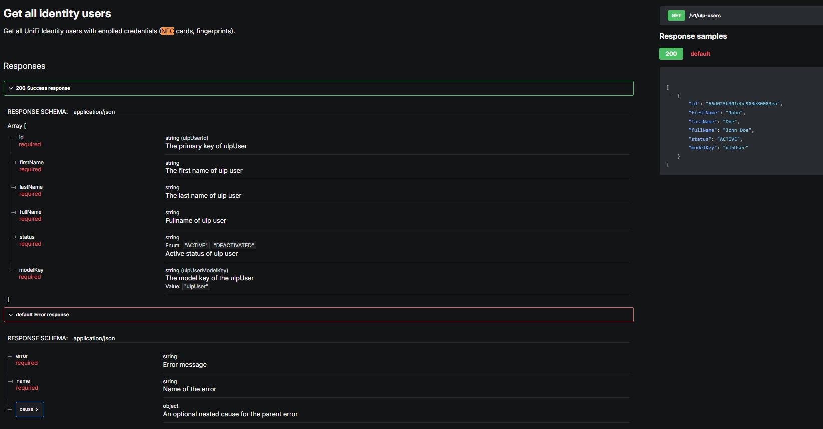

I think that’s done either via parsing the user data from this endpoint /proxy/protect/api/users which does reference the assigned IDs, or perhaps via this credential call. Not sure at present.
Thanks for the information! I don't see an endpoint in the Protect API that enumerates NFC or fingerprint reader devices (like, say, /v1/cameras does for camera devices), so I'm not sure how to get a list of these devices by ID and present them in the UI as devices you could add to the hub -- the idea being that, like cameras, they could be matched to events based on the matching ID from "device" in the JSON sent on a fingerprint or NFC read, etc. But ... I imagine some devices show up as cameras that actually have these features (some/most doorbels? probably not any sensors, but that's the other endpoint the app currently looks at). If so, does that ID match the camera ID, as you'd see in the DNI if nowhere else?

Another is that "ulpId" appears null in your data, but I'm not sure if that's because it was redacted or not. If not, that would be a hurdle towards matching it up with an actual user since I think that's the one you'd need to match these up with Identity users/fingerprints/etc. I suppose at least some event would be possible without that, though.

Agreed - even if presented with an ugly string I’d accept that, although we could present a non-ID based identity other ways. The most likely (and maybe best?) way in documentation I have found indicate that we’d have to read the entire user base (in a home, pretty small) at the /proxy/protect/api/users endpoint, and within the returned user blob there are attributes that indicate the fingerprint/nfc ID as an attribute of user, thus indirectly giving us a user/ID list. My speculation on the other API call “Get All Identity Users” is just that and I’d have to fire up a local VM with the bits to quickly do this (most in house is windows, and tbh I’d use linux to do any probing at that API if you like)

Still also not sure about users vs. Identity users, but their docs make it sound like the latter is the place for fingerprints or NFC (in the former on mine, it's just the users who can log in to the app/web UI).

Thanks for confirming that the device IDs match! That makes things a bit easier (and is probably the only kind of devices you'd expect for a Protect integration anyway, one that doesn't claim to be Access). I think AI made up the thing about binary above; it's all JSON into the websocket, like you see in your logs -- there's no special processing -- so I'm hesitant to trust the rest of what it claims. :slight_smile: In particular, the data.metadata.fingerprint.fingerprintId key it's talking about isn't in your data at all -- the only thing under fingerprint is ulpId, which is null (the docs suggest this is supposed to match an Identity user; maybe you don't have Identity set up, or maybe it requires Access too?).
The "ID" redacted is likely a unique ID per event, not anything tied to the device or user. (I suppose you could confirm with additional logs, but this matches other events unless I'm getting confused. You may see it a few times in logs if there are multiple entries related to the same event, like a start and end, but otherwise it would be different for each.) Without an ID tied to a user, I'm not sure what could be done except note that a fingerprint or NFC unlock was performed on a particular device -- but nothing about who, etc., that I imagine many people would want.
