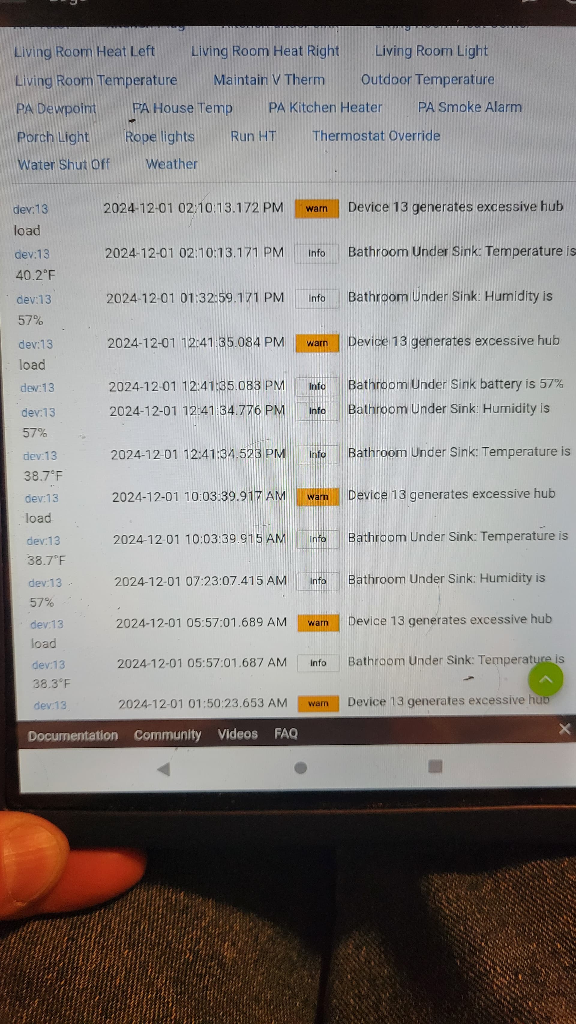

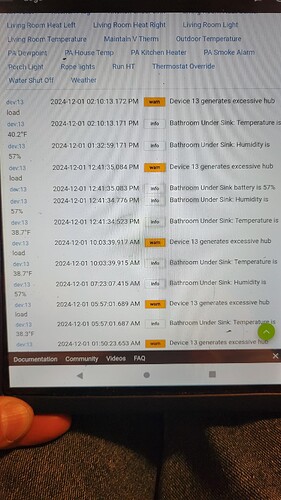

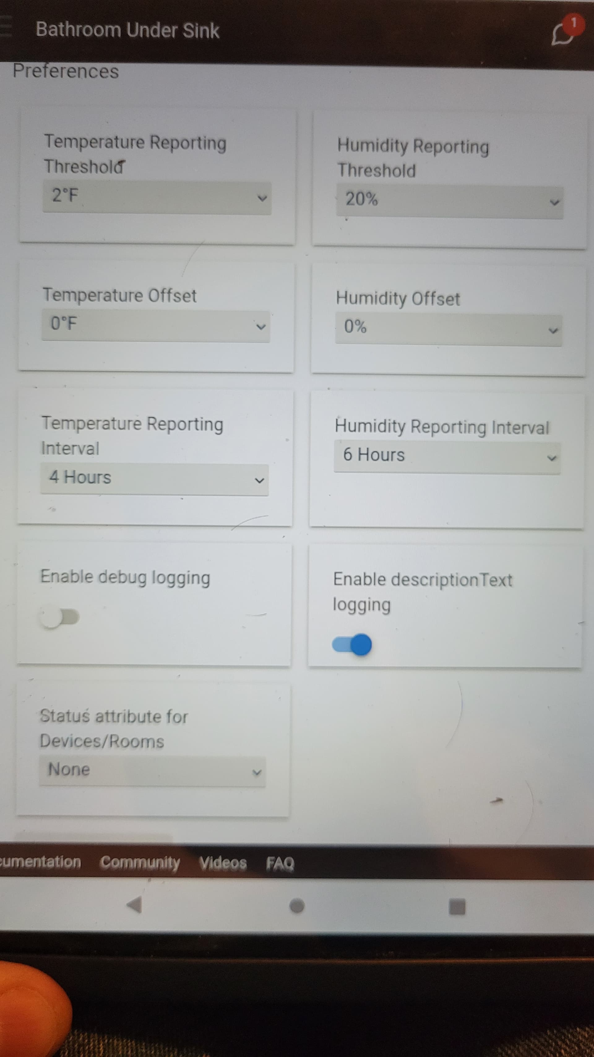

Getting this on a bunch of devices what seems like suddenly... Like... Almost all of them... All look similar, logs aren't getting trashed with a ton of reports or anything.. Example here is a zooz zse44 temp sensor... Seems like what I'd expect for reporting, settings are pretty tame.... Any thoughts? Hub is at a remote location .. It's a C-5 running 2.4.8.139 ... Hasn't been reset in a bit. Going to be there tomorrow so planning to reset it and update the firmware (really don't like doing that remotely as I have heating controls dependent on it). But any other ideas in the meantime?
