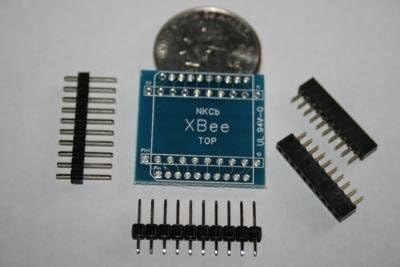

FYI, for anyone looking for a better solution that some of the adapter boards available, specifically one without LEDs to save on battery, I just got this one from Amazon.
FYI, it doesn't have a power adapter built in like the adapter boards available. So you have to supply 3.3v, not 5. But this is a lot smaller than the other boards I've seen.
