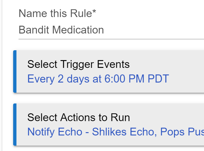

Hey gang,
I need to give my cat medication every 2 days around 6PM
Is the best way to setup a RM4 where the trigger is Periodic Schedule? Still trying to figure out how to start the trigger other than remove the pause on a medication day and let it run.
Am I under-thinking it?
Rick

Thanks for the feedback
It's all setup, now to test and forget :slight_smile:
Rick
