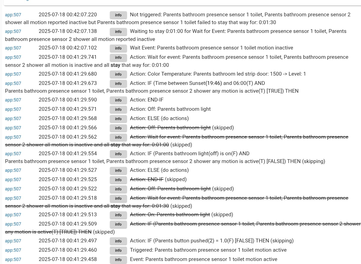

Hi all,
I'm getting a not triggered event but i have no idea why.

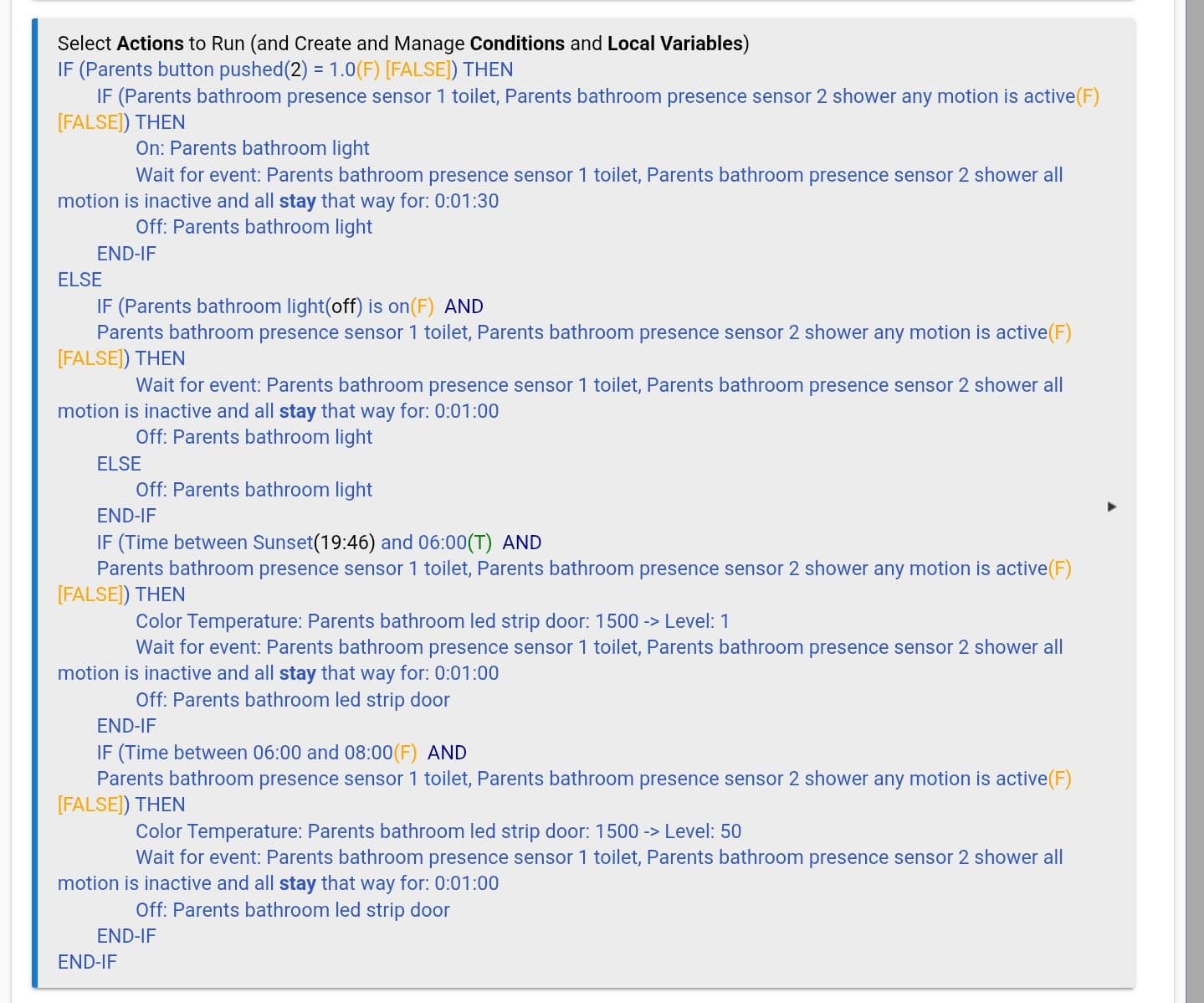

My common sense says that if the presense sensor not triggered to inactive, means that there is motion, so the wait event for motion inactive is still running.
How can i overcome this issue? It happens from time to time.
My guess is that is a logging typo, where it says "Not Triggered" in a context where it should report "Wait Failed". But, you didn't show logs for what followed that, so can't be certain that's the issue.
Go to the App Status page (circle i icon), and Export that rule. Email me the downloaded file. I will look at what's going on....
