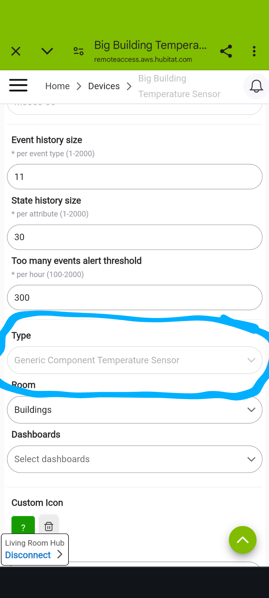

When you click on device type you don't have either of those in the driver list? They are native to Hubitat (built in drivers) so they should be there. If it won't let you click on the type field, click the Save button like you made device settings changes (even though you didn't) and it will let you click on the field and open up all the available drivers.
However, I have to say I don't think any of those drivers will give you a battery reading inside Hubitat if that is important to you.
Also, if it won't let you post screenshots, join the owners group and it will be then slow you to post screenshots. It is a spam bot blocker safety net.
