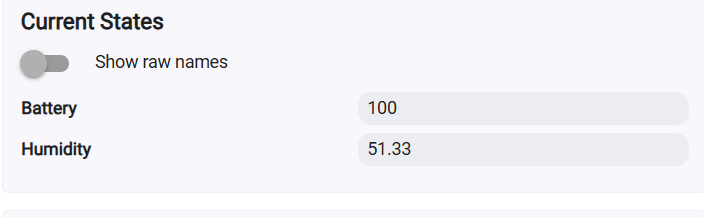

Seemed to work fine so far, until I found that the temperature state was not shown.

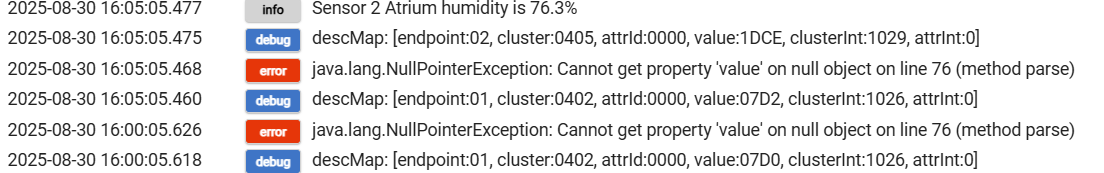

Edit: Here's an excerpt from the logs, maybe the Java error could be a clue?
