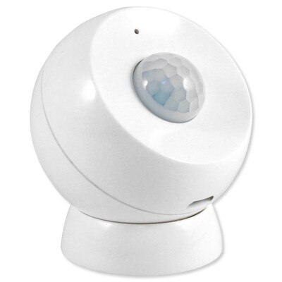

EDIT-found a USB power sensor- Z-wave
I'm also not aware of any, so the two options I can think of are settling for a regular Zigbee or Z-Wave sensor that happens to take USB power and could be used with POE and an adapter just to avoid batteries, or using a traditional hardwired alarm sensor along with some board that can interface with your hub over your LAN if so desired (e.g., Konnected, HubDuino, or other options).
If you go with that first option, besides the HomeSeer HS-MS100+ above, others I'm aware of are the Zooz ZSE18 (nearly identical hardware), the ZSE29 (bulky and meant for outdoor use), the Aeotec Multisensor 6 or 7, or the Neo Coolcam 700 motion/5-in-1 sensor (also found as Haozee and possibly other brands). That last one is my favorite -- not as expensive as some other options (except Zooz) and faster than probably any other Z-Wave sensor I've tried. On the downside, it's hard to find in the US but can be shipped from overseas (e.g., the Neo Coolcam store on AliExpress) if that is not a concern.
Discontinued options you might be able to find on the secondary market include the first-generation (Kickstarter-era) SmartThings motion sensor mentioned above and the Inovelli LZW60. Or, you could get one of those CR2- or CR123A-shaped "battery eliminator" things that take micro-USB power and use it with about any device.
