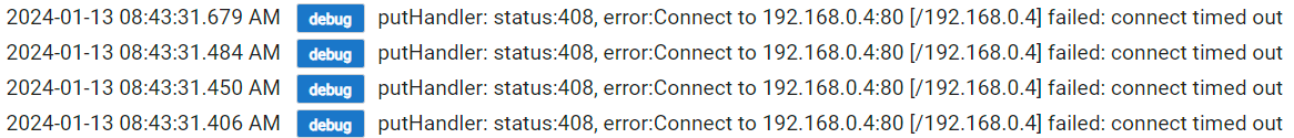

Here are some of the examples for the past couple days:
Many more of these repeated...

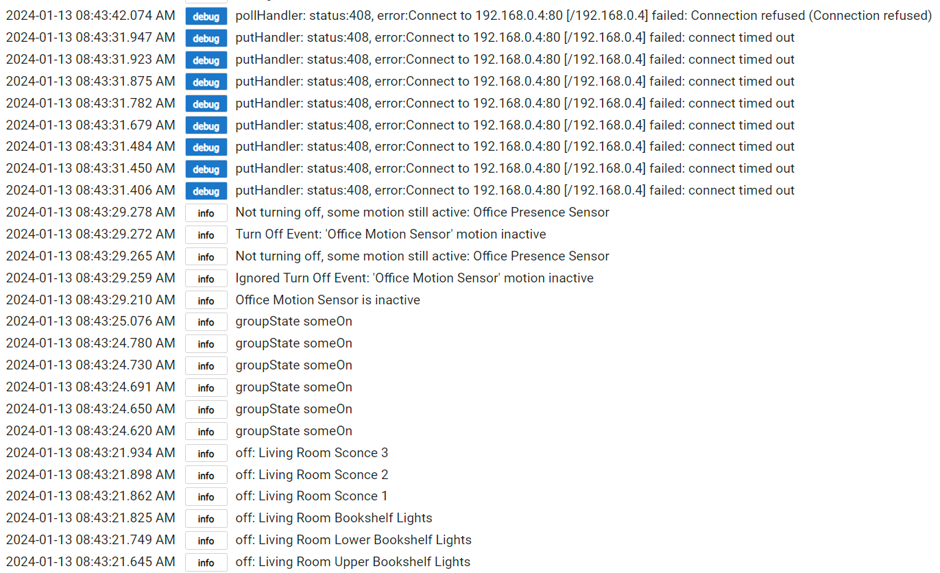

This is really causing me fits over the past week. Periodically it seems like the Hue hub gets briefly into an unhappy state. It starts with a series of these errors that don't seem connected to any hub action. I assume it's the Hue polling service? Is there any way I can see more detailed logs for this?

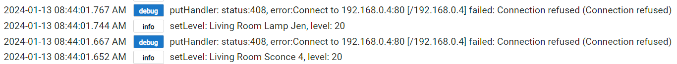

Then when the hub actually tries to issue commands to devices shortly after, this happens:
Then it will just start working again 30s later. Meanwhile my lights are left in funky states.

Thanks for the insights on polling, that makes a ton of sense. Looking more closely, there was a 10s gap between the last commands issued to Hue devices (living room lights) and these errors in this instance, and there were 8 "offs" issued now that I look at it. That must have just been the period between issuing the requests and them timing out.
