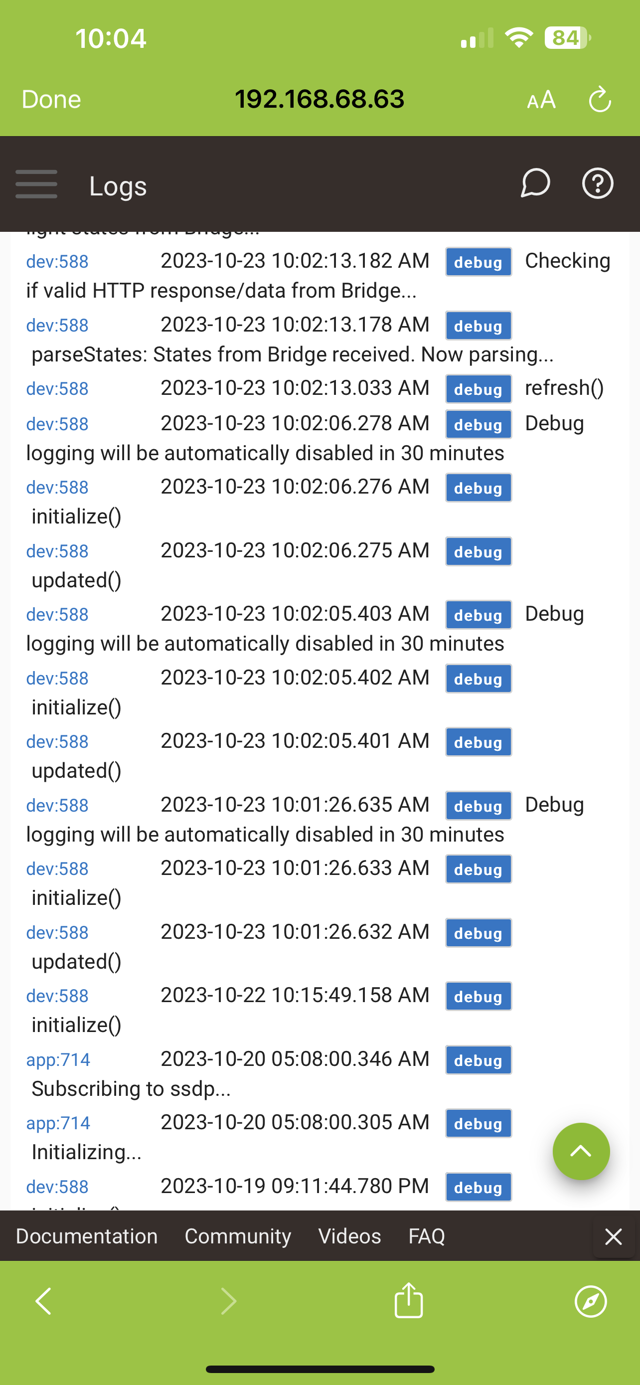

I would need debug logging on for the Bridge and device in question, with a screenshot of the log entries filitered to just those two devices, in order to get a better idea of what is happening. (This is a preference you can enable on the devices if you are not familiar.)
Ok. Thank you.
Is this helpful
Oh ok. Thanks.
No, there are no errors in those logs. :slight_smile: But if everything is working fine now...

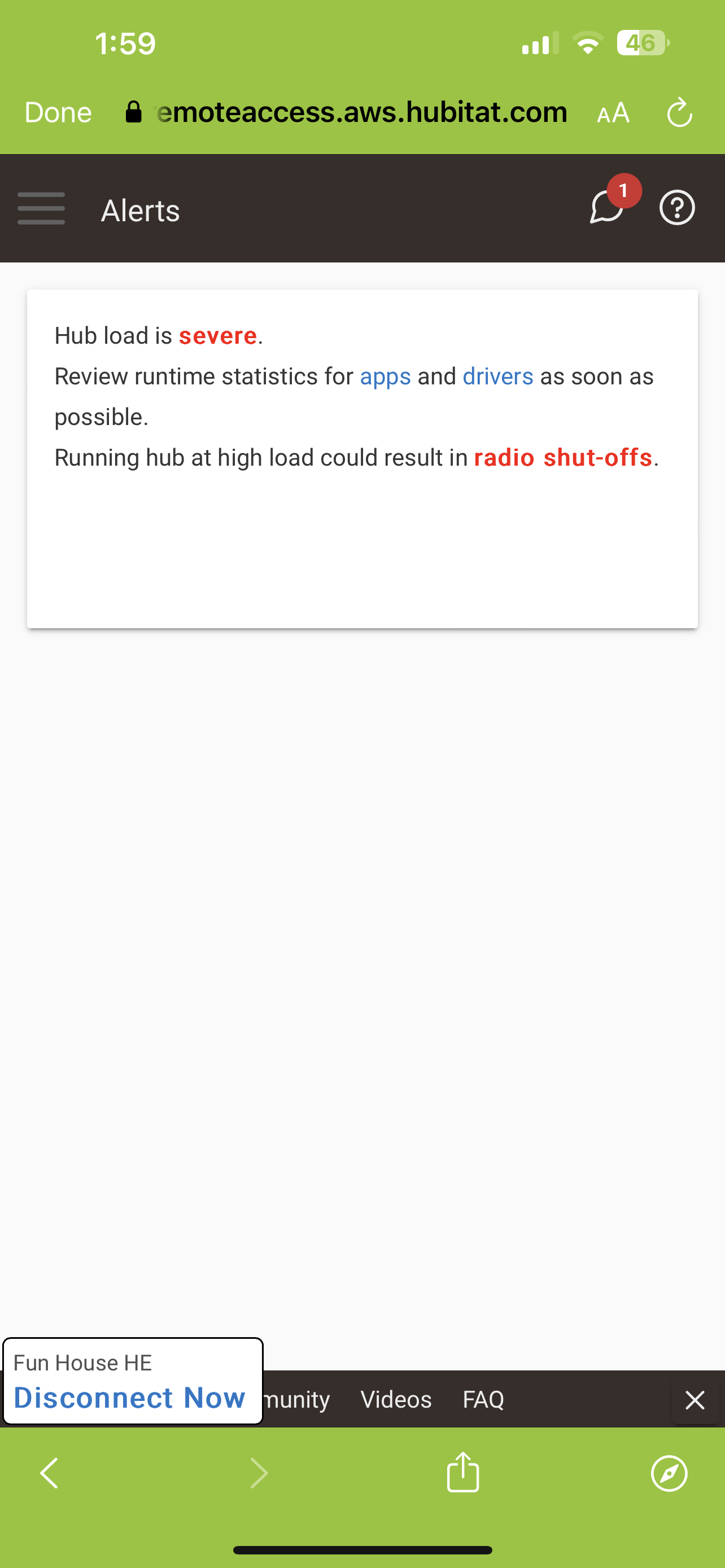

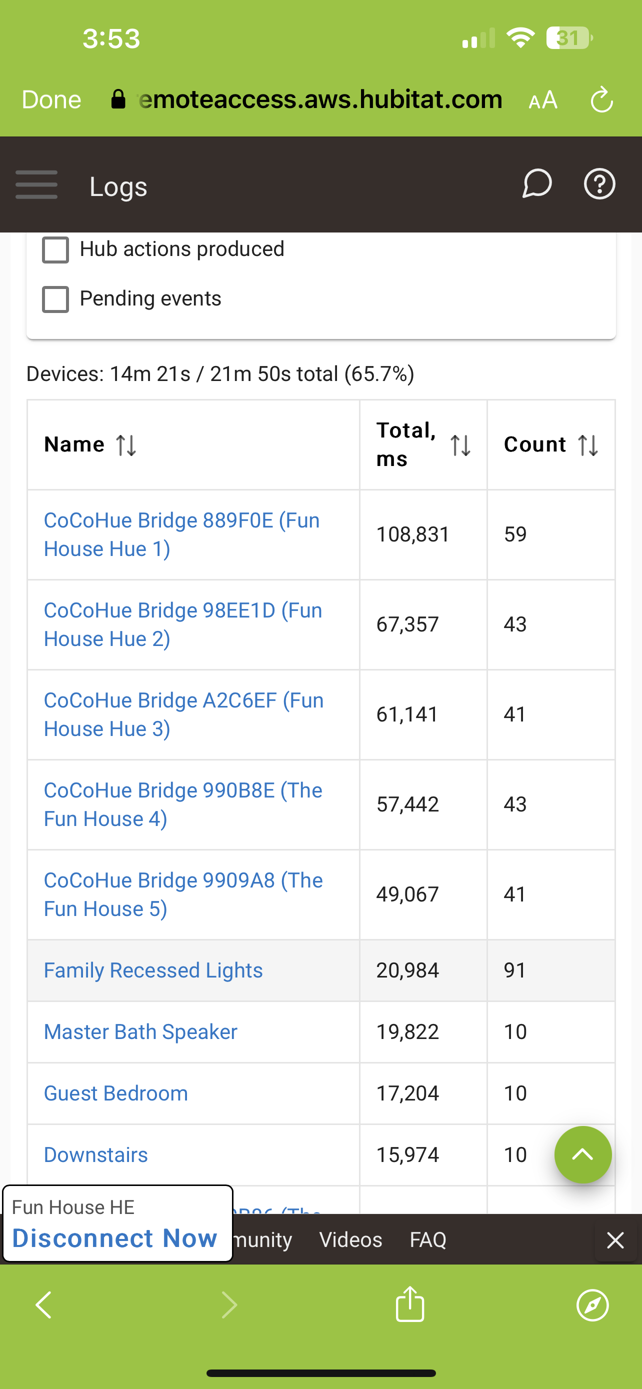

Got these messages
Not sure what is solution.
Could this be the reason my zigbee radio drops off.
Now running hub mesh and have shared all my blue switches. Set power reporting to 0.
That's a lot of Hue Bridges. :slight_smile: Do you have polling and eventstream (instant status) enabled on all of them? You could try toning down the settings for either or both if you do.
Theoretically, with eventstream enabled, you could get by without polling, but Hubitat still seems to spuriously report disconnects of the eventstream every once in a while and also truncate the data if there is a large amount coming in at once, so some things may be missed, which a poll would catch. If you only or mostly make changes from inside Hubitat (or don't care about needing to wait for changes made outside Hubitat), you could leave eventstream disabled and just rely on polling. Which is best for you will depend on what kind of changes you make (again, mostly from Hubitat means polling shouldn't be a problem) and how much traffic (changes) you have coming from the Bridge if everything is pushed instantly compared to how much a periodic poll generates (which happens even if nothing changed).
