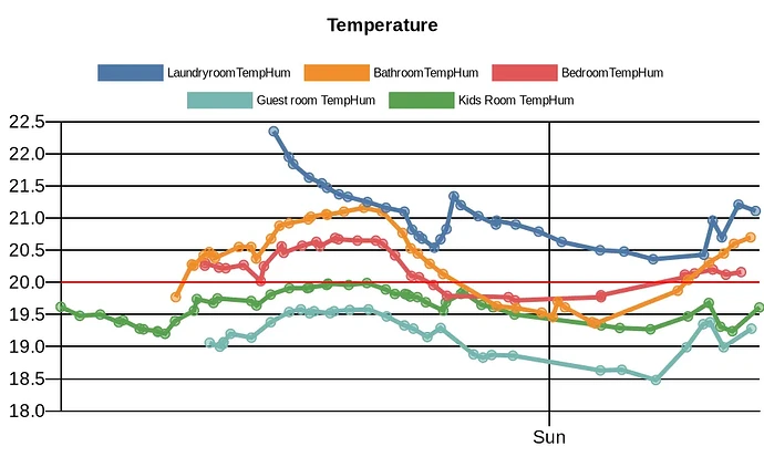

Hence my question, if i don't want to recreate devices and change all the dashboards and automations, just to be able to set the temp sensors to trigger hubitat events everytime the sensor itself fires an event.
Here's an example, on the left i miss data because the hub had frozen up, on the right side you can see that the granularity went down since i switched to the official driver, and i believe that unless the temp changes by 0.25C, the event from the sensor is not fired as a hubitat event
