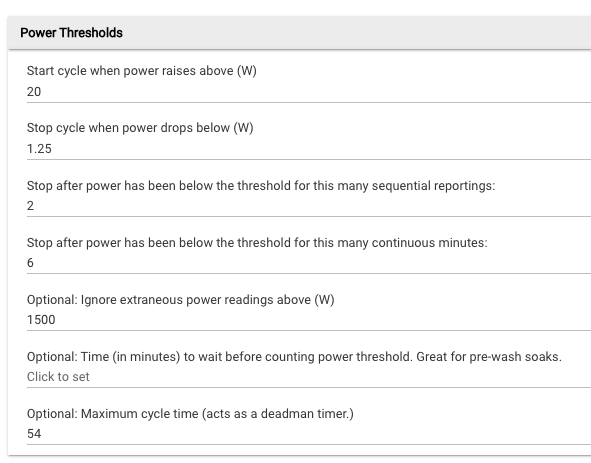

There are enough options in BML that I think it best if you give me a screen cap or two. The screen above shows two monitors, and each can select its own Device to monitor. The error indicates you've picked Power Meter.

That's the reason for the optional Maximum Cycle Time:
In my case, I'm saying, "ok, it will never take more than 54 mins to run the washer." If the reporting from the power device doesn't catch every watt of change, then the 'dead man timer' forces an end.
What I've suggested in the past is to look at the logs for the device during a cycle and plot it out and determine the high and low values.. and it may be very close.. 5 watts or more means ON.. so what if it's 250 watts, it's still more than 5... same at the OFF range. You may see 4 watts multiple times but not 3.
That's the down side of these wonderful Low Energy products.

For stop cycle below threshold, I have 4W and "2" for sequential reportings and minutes. Are those an AND or OR? Because here it looks like I hit two low reportings in a row, but it waited a further 2 minutes to mark as done?

But 8:27 is 3+ minutes ago, shouldn't "Stop after power has been below the threshold for this many continuous minutes:" being at 2 have triggered it to complete?
Stop after power has been below the threshold for this many sequential reportings:
The two Thresholds are sequential. Here's my first example: thresholds: 10.0 4.0 2 0 Those values are what I have set: 10W (on), 4W (off), 2 times, 0 minutes. I then set power to 50 W and that starts the cycle. I lower power to 2.678W and the first delay occurs. I then set power to 1.567 and the cycle ends.

I think that most closely matches your intent. By setting number of minutes to zero, then when the 2nd power report below 4 W, the cycle ends.
The answer then to your first question is that the 2 min timer starts after the 2nd low power occurrence. If I set the minutes to be anything, 2 in your example, and only get 1 low power report, the cycle does not end until the deadman timer fires, which confirms the sequential nature of the two thresholds.

If threshold is ie 2W and only 1 sequential, but 2min time - if it drops below 2W but then hits a higher W will it cancel out the stoppage, or continue cycle end because it did get below and it’s simply waiting now. (I guess if it DOESNT get canceled I don’t get the use for the delay time)

I use BLM myself, still... and in the past year I replaced the Washer and Dryer (gas) and had to reconfigure the Thresholds. I did the same as I had done with the old set. I ran a cycle or three and captured the logs. I then, more or less, plotted the power values. That allowed me to set a low power value and really, anything above that was good enough to be the cycle start level. Then, looking at the end cycle, I had to count how many times it fell below. Finally, I set a Maximum Cycle time, with some round up, so that no matter what, I'd get an end.
