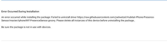

Now I'm stuck in a loop. When I try to delete it I get this error:
But I can't see any lingering devices that still use this device code. And I don't see it listed in Devices Code, Apps Code or Libraries Code.
HPM shows it was an installed package but won't let me uninstall it.

In HPM go to Settings and select Unmatch, and then select the driver.
That did it! Thanks!
