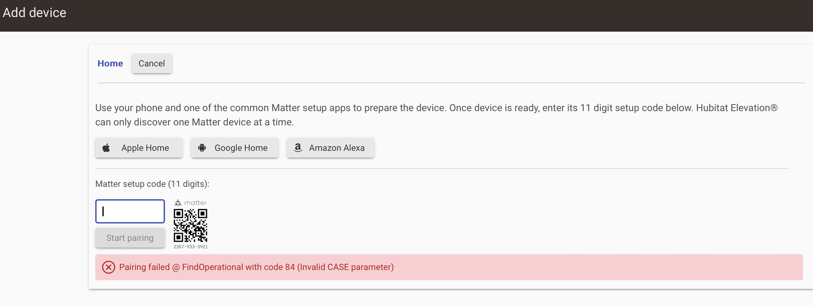

So attempted to add the device to my Hubitat C-8 running 2.3.7.141. All Matter device drivers are stock; nothing added from any other sources. Started pairing mode from Home app, entered the setup code, then got this Hubitat error:
I wiped the pairing code before taking the screenshot above. No messages in the Hubitat logs were observed.

This error went away after upgrading to firmware 2.3.7.143.
