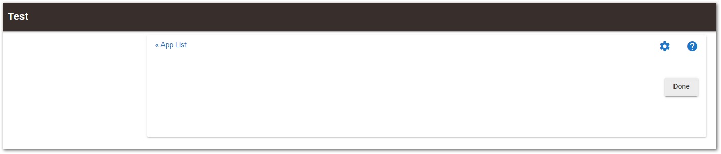

  12. Set "Temperature Offset" to "-4"
  13. Click "Done with this Trigger Event"
  14. Click "Done with Trigger Events"
  15. Click on "Select Actions to run"
  16. Observe blank portion of the page where actions list would have been:
  17. Click "Done"

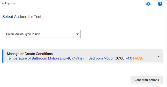

I just followed your steps exactly and don't get the same results as you. This is what I get when click 'Select Actions to Run'
I'm not suggesting that your not having this issue just that I can't reproduce it in my system. I wanted to see if it was a bug that impacted all hubs. I'm running 2.1.7.127
Interestingly, I tried a variety of other triggers and did NOT get any errors - just with that specific temperature one...

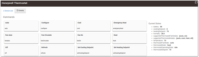

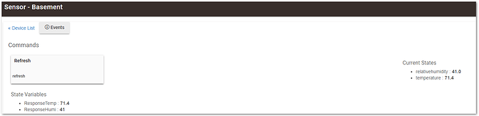

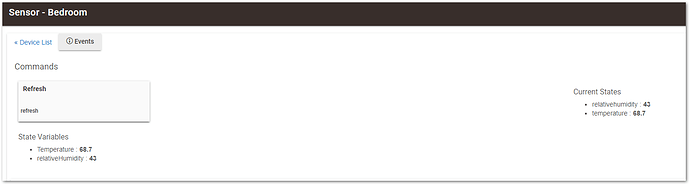

Looks OK to me:

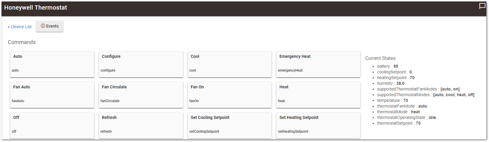

The "relative to" device was a thermostat:
Both seem to have a valid state with the name "temperature"...

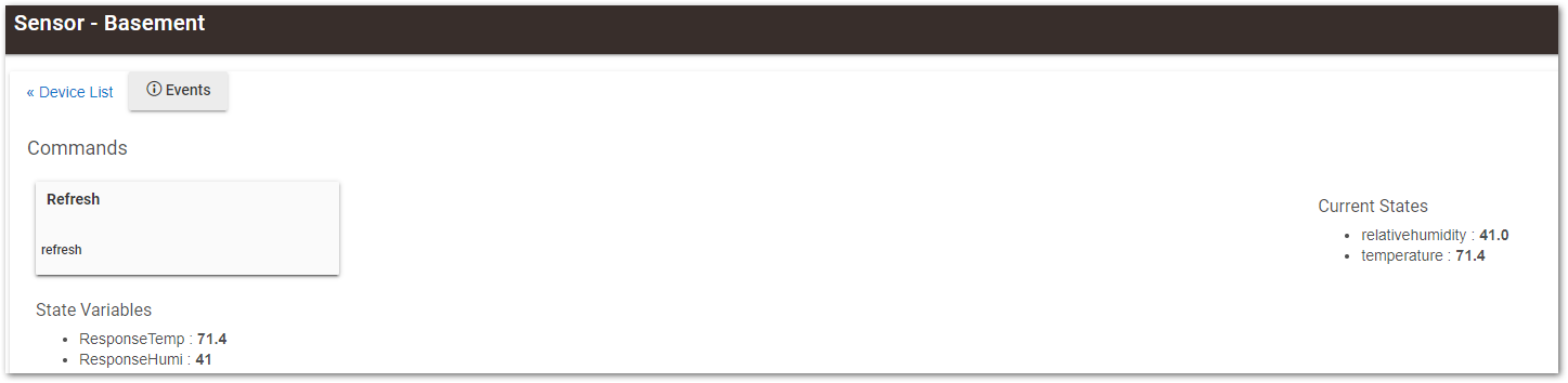

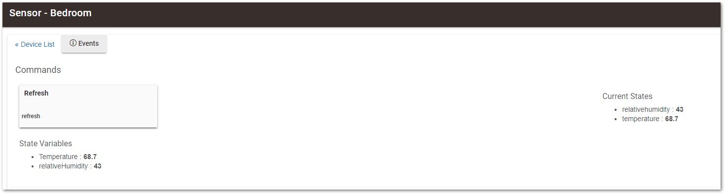

But: next I'm going to pick different devices for both of these (especially the first one, given that the driver for that one was written by me :thinking:)
If I start with a different device, say a motion sensor that also reports temperature, THEN edit the trigger and change it to my temperature sensor in question, Actions work properly!
Only if I start right away with this temperature sensor as part of the trigger, then Actions throws that error, and after that the rule becomes "broken" no matter which device I change the trigger to, or even if I delete the entire trigger...
I've put the source code for this driver on GitHub: levvp-TempHumi-Sensor
There, on line 56, I'm getting a plain-text temperature value, converting it to a float and sending that as the "temperature" event.
In the device I can definitely see the value:
Of course, I wish there was a way to get a response from HTTP GET action in RM and assign it to a variable... Then I wouldn't make some kind of a mistake here :grin:
Can't see what's wrong though...
