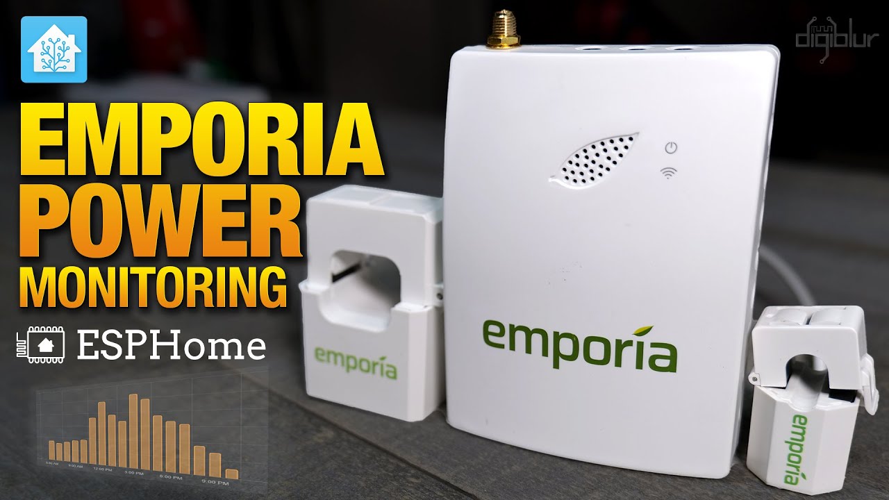

I’ve been happy with Emporia Energy, but there are no local options, so the one you are suggesting seems much better from that perspective. I would get 2 to cover all circuits. That’s what I did with my Emporia, though with that one, there’s an option to combine them together into a single output.
Supposedly, it can be flashed to run locally but looks like a huge PITA and i never considered it.
That should start video at point where he starts the flash process.
I like my Emporia Vue 3. I have a 2nd and 3rd sitting in boxes because i have approx 24 circuits in my 1st electrical service along with 2nd service with 8-12 more circuits.
