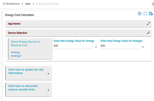

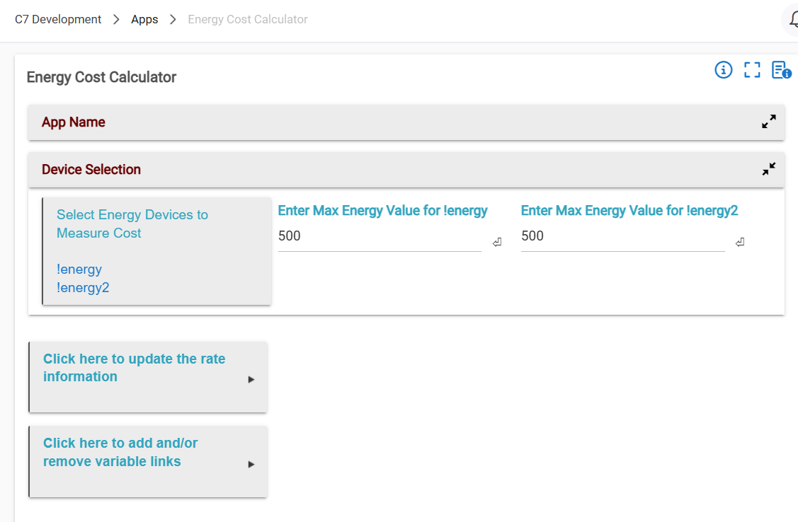

Went out and looked at the code, assuming all you need is max value check per reading per device the code at https://raw.githubusercontent.com/thebearmay/hubitat/refs/heads/main/energyCostCalc/EnergyCalculatorPlus.groovy should work.
I made a change to the max value check that was already in the code but then added a check on max cost allowed to prevent anything else getting through.

I moved the check to the event handler instead of where it was - logic should do exactly what I intended in the first place now.
