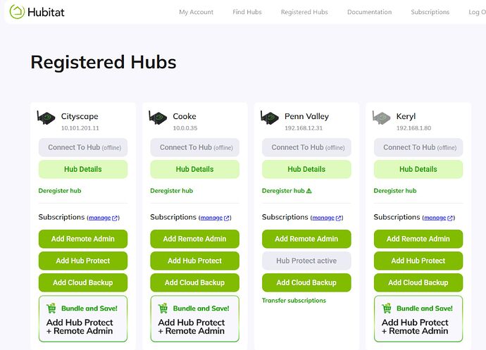

Third time I've posted about this issue. Once again, I've lost access to Remote Admin at the end of a month (billing cycle), from the "updated" Registered Hubs page. I can get in if I'm taken to the "old" Registered Hubs page, but I haven't figured out how to specifically navigate to that page.

Can you get a screenshot of the effected page while it is still broken for the end of the month? @bobbyD I am sure will be interested to see it.
I don't seem to be having any issues with remote admin, so I don't think it is a widespread issue, possibly a glitch specific to something on your account.

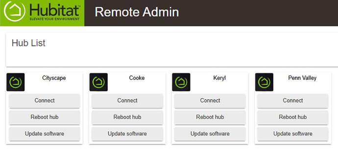

Here's the page that works...
I assume the issue is the portal thinks they are offline?
Can you click on Hub Details and see what the "Last Checkin" is showing? Is it recent within last 12 hours? If you do a screenshot, do not include your HubID or MAC.

That is the Remote Admin direct login page. It is currently in use. When using the Hubitat login, it actually logs into this very page.
