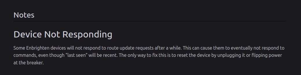

From Z2M support:
:frowning_face:
Thanks for the (sad) info!
