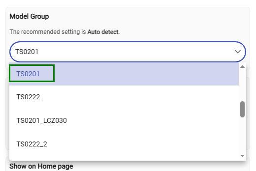

@kkossev Is the above referenced Tuya Multi-Sensor 4 in 1 the correct driver to attempt to use with this Temp & Humidity device? The device data, which is what I think you typically request to make such determinations, is this:
@calinatl , the right custom driver to use with this device is the Tuya Temperature Humidity Illuminance LCD Display with a Clock driver.
This new devce fingerprint is not in the driver code yet, so go to the Preferences tab 'Model Group' and manually change it to 'TS0201' and click save.
Then, obligatorily, pair the sensor again to your hub.
Let me know if this makes any difference.
