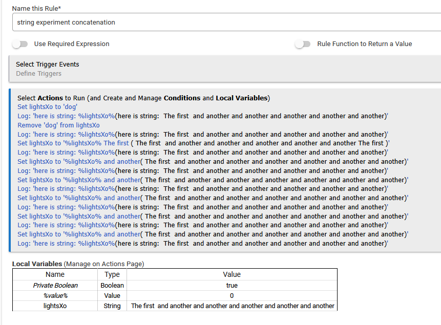

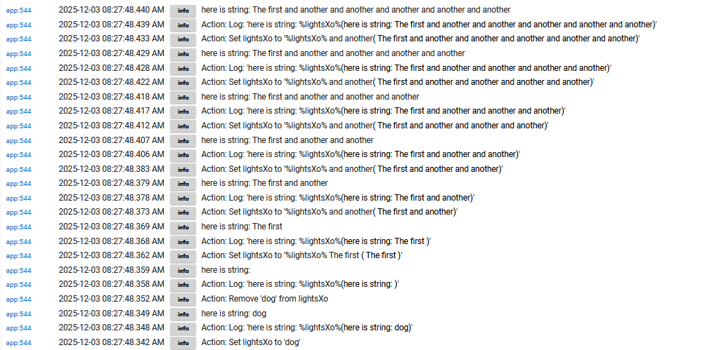

Go easy on me on this one...... I am using a string variable to keep track of outcomes in a rule with multiple Ifs.
I want to clear the string at the start of the rule and then add characters to it at each successive if. Then record the string to the log.
This should be trivial but for some reason I can't see to clear the string easily. The only way I could get it to work was to write an arbitrary string (dog) to the variable and then remove that same string in the next instruction. I tried setting string to '' and "" and ' ' and " " but these didn't clear the string as I would have expected. I also can't use the set variable and leave the field blank as you can't exit the set command without putting something in the field.
Maybe I didn't have enough coffee this morning. I am sure I must be doing something stupid but I've tried many different schemes... Ideas?

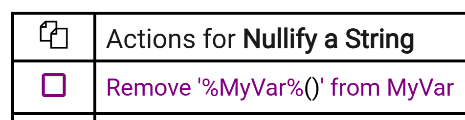

Technically you can nullify a string variable with a single action like this:
but you will no longer be able to click on it (to manually edit). Still saves you a step. Let us know what you're really trying to accomplish here.

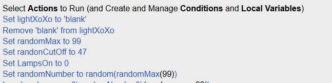

Just wondering why I can't reset a string variable to empty with a simple one line command. The rest of my rule works fine. I am only puzzled by the inability initialize the variable to an empty string each time the rule actions run. I would have thought set variable to "" would do it but alas no.
So my solution is simply set the variable to a known string (blank) then remove that string. Seems unnecessarily complicated but it works. The single quotes and double quote methods didn't work. I can initialize a number variable to any number with a single line in a rule, don't know why I can't do something similar with a string.
Initializing with a number is initializing with an actual value as opposed to no value. You are actually doing the same thing when you are initializing a string with "dog" or "blank" or even a single letter.
