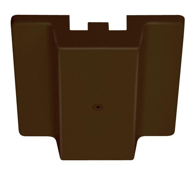

I was thinking, if you can get the end of the LED to an old work box in the ceiling, you might be able to use one of these to cover the connections from the LED to the box. Basically it would be the same as the termination of a track light.
I realize you don't want brown but it was the first I saw.
Termination cover

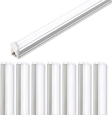

Here is a link to the LED’s.
OK thanks. Looking at the wiring options of these, I would have to agree with what others like @JohnRob suggest and add a single gang plug near each light that you can simply plug them into.
