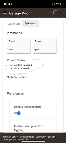

See device and notification rule below...
With a dead battery in my FOB, the GoControl opener sent the signal to open the door but the door never opened because it never received the wireless command.
In that situation, the device page showed:
contact: closed
door: open
The actual door remained closed but my notification triggered to tell me that it had opened.
