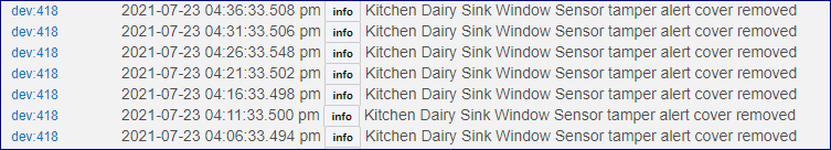

Does anyone know how to turn off the "tamper" switch on this device?
