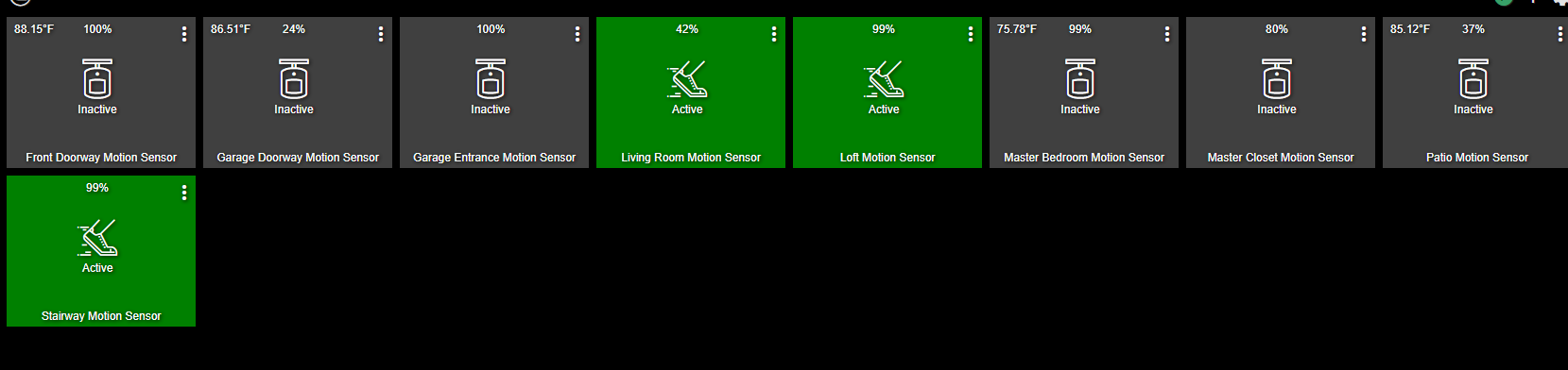

I just made the switch from ST. I added all my motion sensors and noticed a prolonged motion detection even several seconds after I left the room. This is causing my alarm to trigger when I leave. Here is the a photo of what I am looking at after I leave the home. Does anyone have a solutions for this?
Ecolnks have always only cleared after about 3 minutes. There is a test jumper for quicker response but it will eat battery. They were no different in smartthings.
