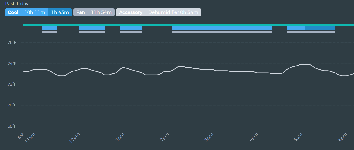

In the summer months, I’m noticed the EcoBee has inconsistent staging, here are two examples from the same day.
2:15pm to 4:30pm:
  • tstat senses 73.3, and triggers stage 1
  • Stage 1 runs for 26 mins
  • During Stage 1 time temp climbs to 73.9
  • Stage 2 is triggered at 73.9
4:50pm to 5:55pm:
  • tstat senses 73.4, and triggers stage 1
  • Stage 1 runs for 2hr 11 min
  • During that time temp climbs to 73.7 and slowly tapers to 73.1
  • Stage 2 is never triggered
In the above two examples, my max stage 1 runtime is set for 35mins, yet in the first cooling cycle the Ecobee completely ignored it and never triggered stage 2, even after 2 hrs. In the second cooling cycle it triggered stage 2 early (in 26 minutes) instead of the preconfigured 35 minute max runtime for stage 1.
While I don’t mind getting tips from the community regarding how to best setup my Ecobee, I’ve tried every possible staging configuration and I’ve yet to find consistent results, presumably due to some hidden Ecobee backend logic that I can’t control.

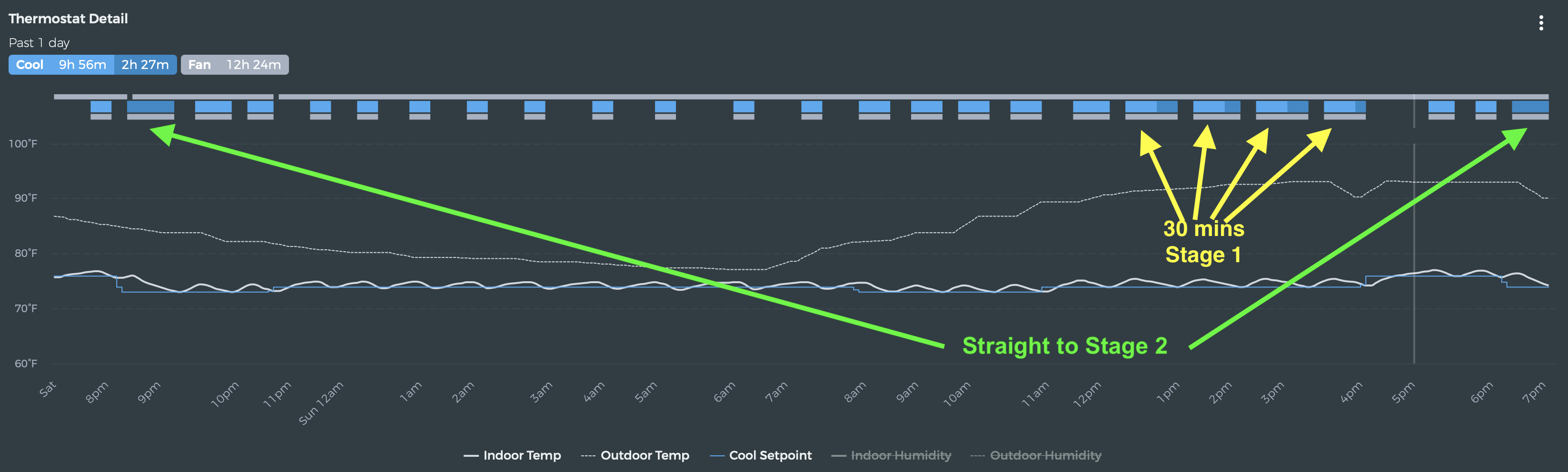

Personally, I went back to using ecobee thermostats. I have an ecobee premium controlling a 2H/2C system in the house I moved to 3 years ago. No issues such as those you’ve encountered. For example, look at the Beestat profile below for today.
There are several marked examples of the system cooling in Stage 1 for 30 mins before switching to Stage 2. There are also examples where the system goes straight to Stage 2 based on the cooling demand (temperature delta).
Edited to add:
I went back and re-read your post. I used to have an ecobee3 in my old house - I’ve never seen the anomalies you report. At this point, I am inclined to believe that either your ecobee3 is defective, or there’s two (or more) conflicting install settings.
