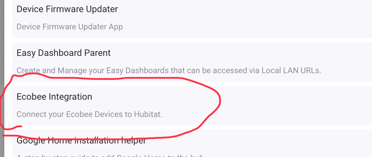

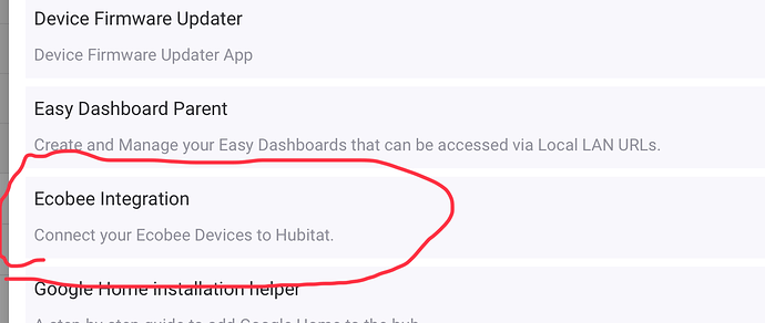

I use the built in Ecobee Integration app with success. I currently uses 2,571 and it DOES support the Away and Resume commands. FWIW I use it with two thermostats and two remote sensors.

Are you sure you're talking about the homekit ecobee integration? I'm using that and I don't see any support for remote temp and occupancy sensors in that integration yet. I think they were specifically called out as not yet supported. Has that changed? Or are you talking about a different ecobee integration?
Not HomeKit, the Hubitat supplied app.
Thanks, since the topic title was regarding Suite Manger vs. HomeKit, I got confused (and temporarily all happy) thinking the HomeKit integration had been updated to support the remote sensors. I jumped the gun a bit... :wink:
